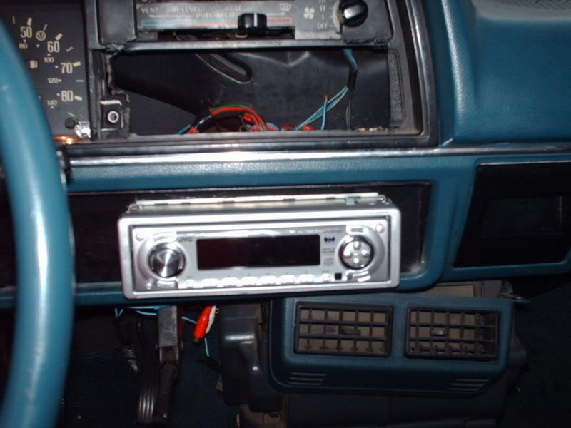

also are you trying to put the cd player in the stock location cause depends on how large the cd player is it wont fit only thing i found will fit in that whole is like an eq, but i just put the lil extra cubby whole and it looks great. no pics of the cubby hole but i have one of were my cd player went and the bracket we made for it.
sorry i thought i uploaded my good pic of it, but when i get home i will upload a better pic, but u get the general idea

like i promised

seats are from a sport trac there not being made anymore but im bout to get rid of them being im 5'11'' and wanting a 3" body drop=not good for head clearance.
I ran all new wires and its straight wired, theres no real advantage or disadvantage, i mean you will have to manually turn the radio on and off but its no big deal, but u can listen to your radio without the keys in the ignition.
