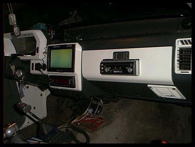

tucnrim2004
this is a firends mazda... since i relocated he says he has done more to it... hope to see soon.....
but to keep it on topic.. here is his monitor in dash that he glass in my living room... it came out pretty nice....
