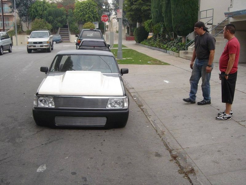

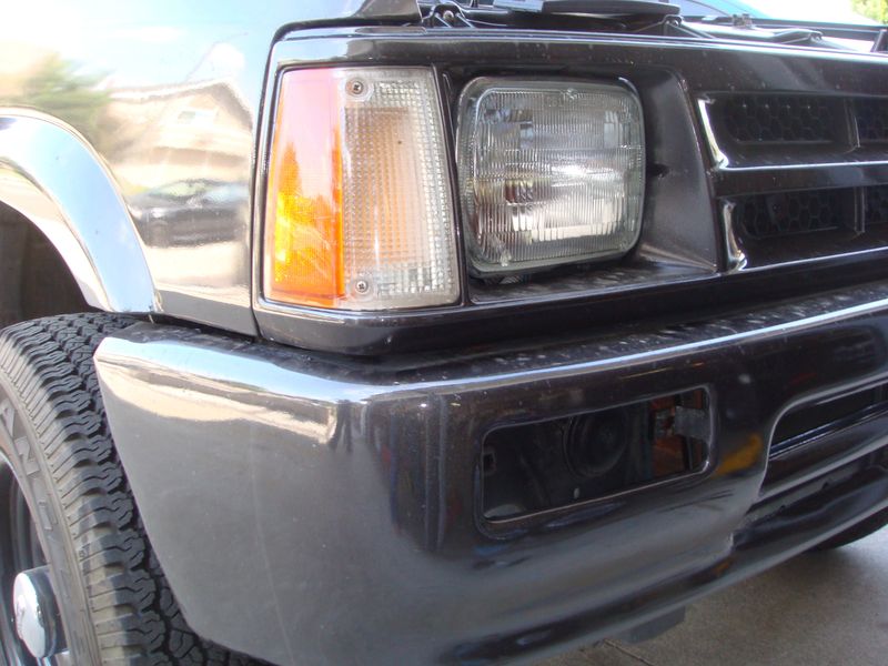

Anybody happen to know what bumper this is or how it is made (if it is in fact a two piece)??? Really love the way this looks and would love to buy/fab one for my truck!
Thanks guys
primeisfine's avatar
primeisfine

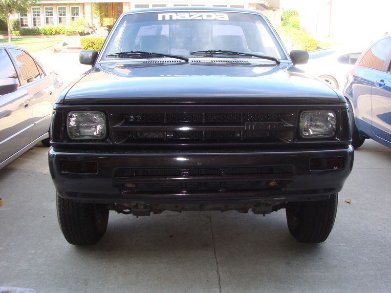

It was a Toyota bumper from Grant. It was literally just the two metal halves (upper/lower) of a factory bumper and a ton of mud over the front. When I pulled it off to reprime the truck, it had cracked out everywhere. I started trying to fix it and realized that it literally was solid mud all over it. I threw it in the scrap pile.
I'm assuming you got that picture from me based on the title. Do I know you? I know a lot of the Mazda guys in the Lincoln area, I used to live there.
low_life77's avatar
low_life77
I figured thats what it was but thought I would ask. So instead on just filling the gap between the two yota pieces with filler would it be possible to just weld them together or fab a say like an 18 gauge piece of steel around the seem and then fill over it? And wow small world man I use to live there as well. But naw I don't think we have met although I do know a lot of the mini guys in the Lincoln/Columbus area. I just found that pic in an old forum and was really digging the bumper! I'm going to be doing the FE3 swap this winter and boost it so I'm looking for something exactly like you're old bumper to place my front mount in. Thanks a lot bro.

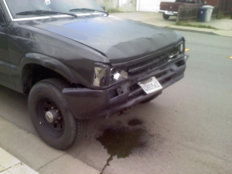

I had a two piece toyota all metal one that I welded together and added some extensions to the end to meet the fender, then bondo had it for about 5 years... but sadly its destroyed now.

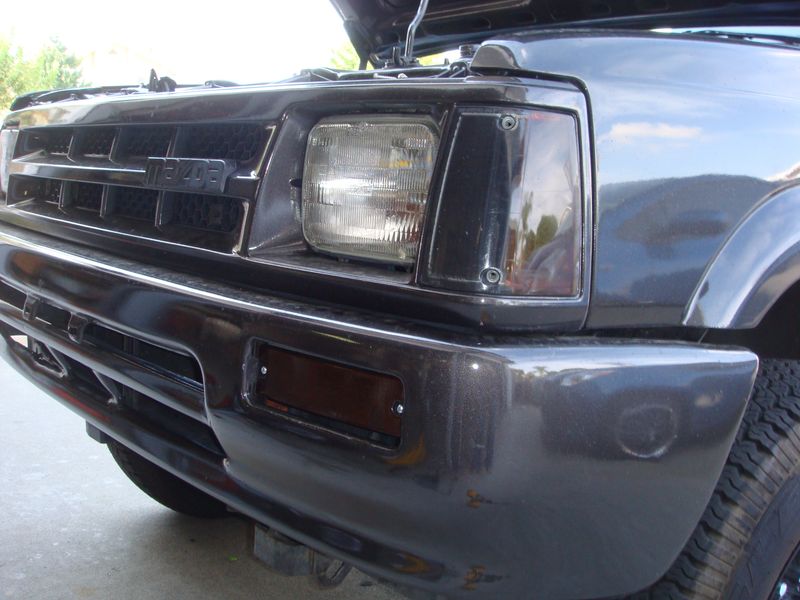

Spacemonkey had the 2wd bumper while the other guy had a 4wd bumper. The 4wd bumper is taller and more popular on mini's.
primeisfine

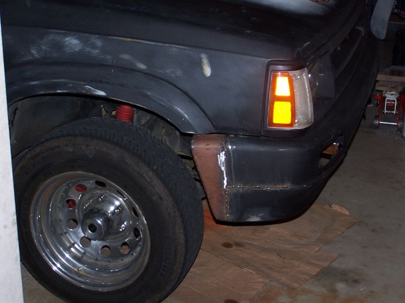

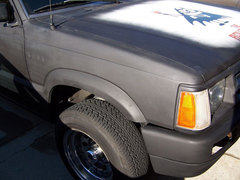

Here's a few more. The statement about it being 4wd was correct.
spacemonkee23's avatar
spacemonkee23
Yes! I went 2wd bumper because it was thinner as I am lifted and wanted the clearance. For lower valence use the 4x4 bumper
