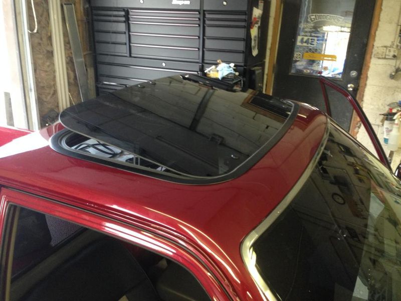

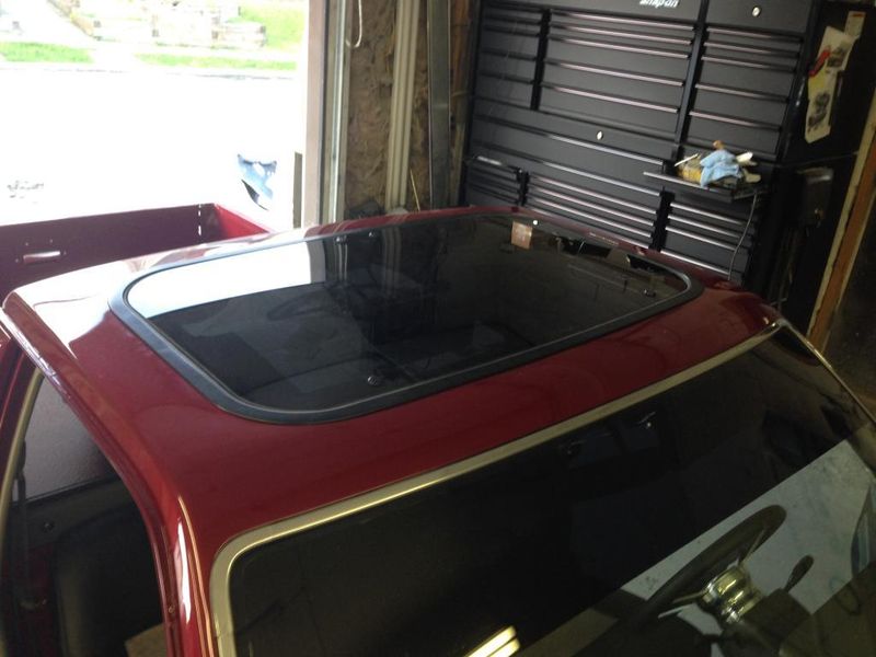

Im actually installing that same one on my regular cab... Going to have to trim into the bracing at the front and the back though. But for a cab-plus, you should be fine.

Installed the Newport 2238 last night in my regular cab... so it will definitely fit in your cab plus. Easy install!
Looks nice!

Mike - that looks great. Personally, I wouldn't want that in Arizona, but nice for Pittsburgh.
