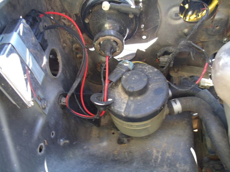

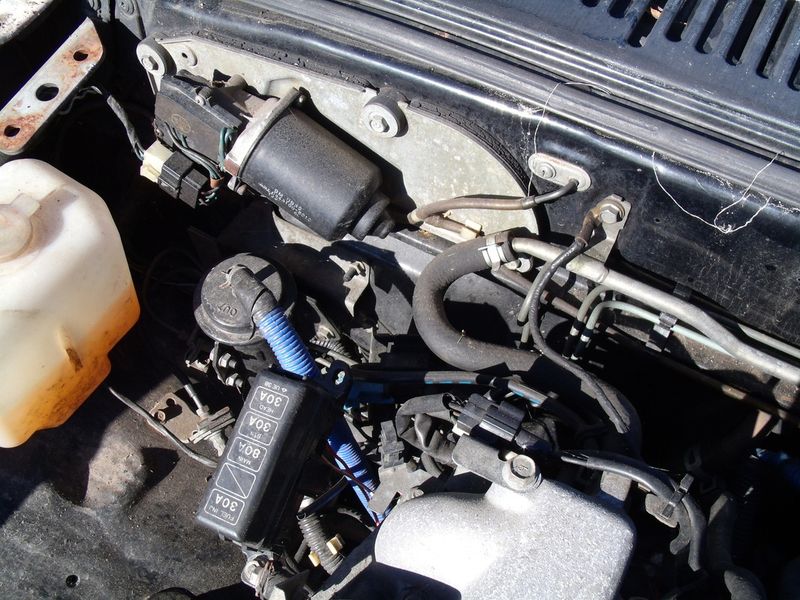

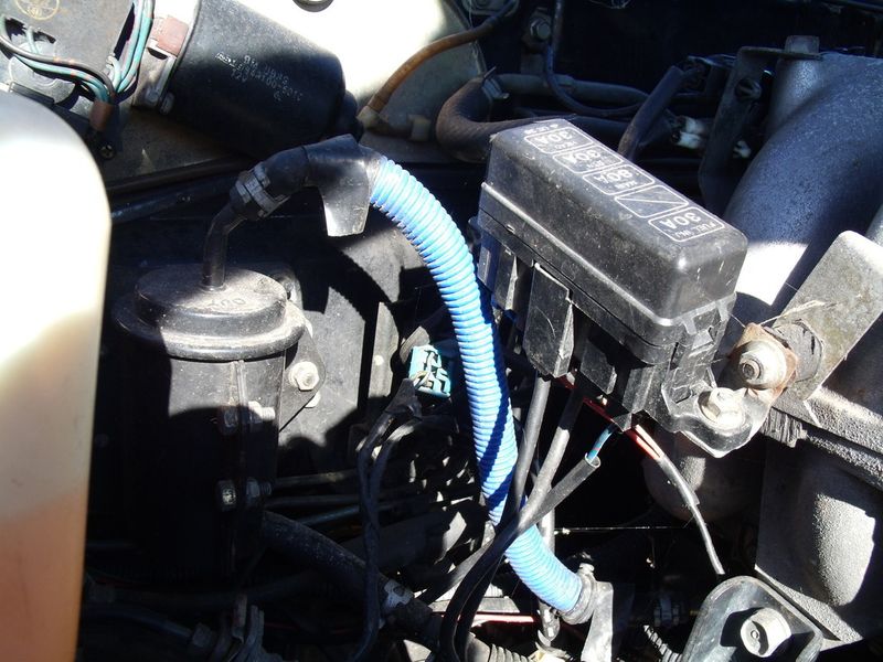

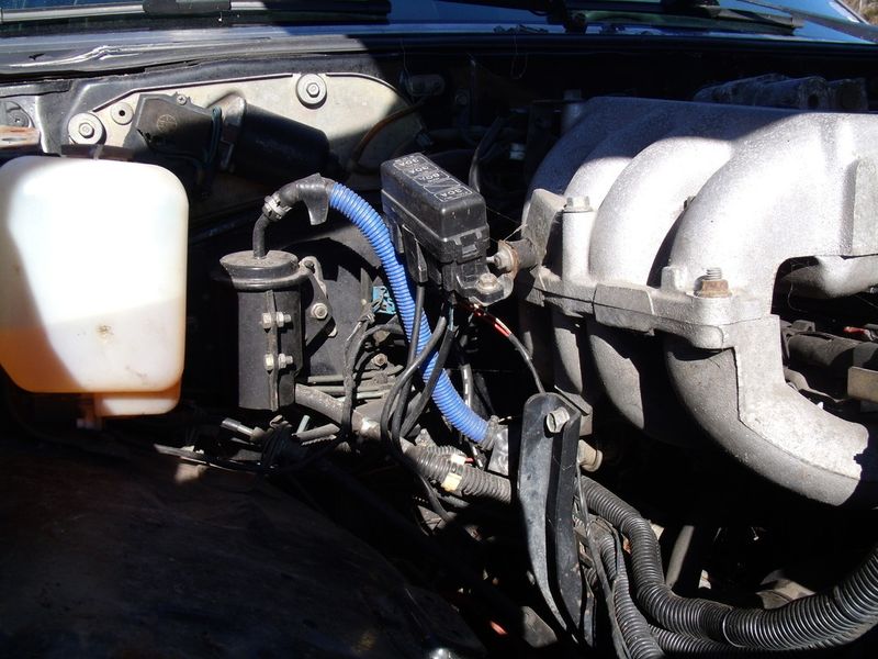

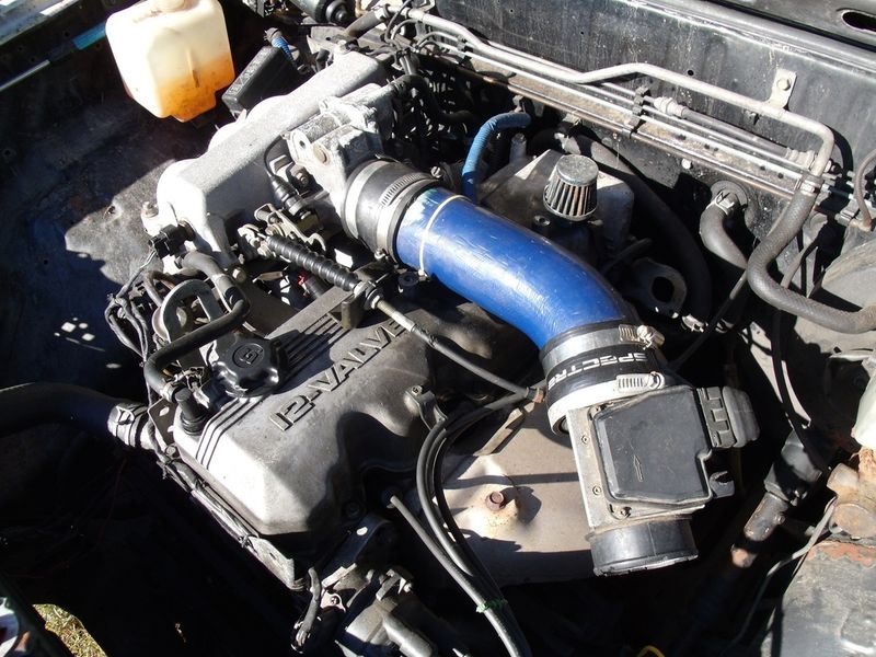

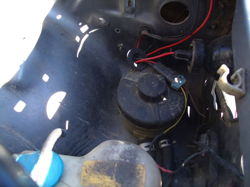

I relocated, and removed just about everything in my 2600i bay, including emissions stuff. I'll get some pictures for you Wednesday when I'm off work and can play i the daylight

and in no particular order...
91extcab's avatar
91extcab
thats whats left of emissions/relocation of power steering res... let me know if you want anything specific photo'd that i didnt get and i'll see what i can do
