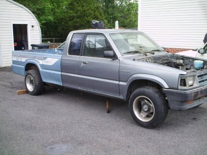

I really dig the look of the ex cab with a long bed. What would need to be done to run this configuration

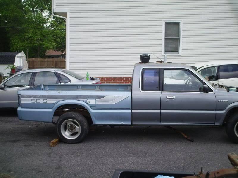

I've already done this and was able to do it using all factory parts. Was not too hard to do and I can explain if you would like. PM me your number and I can explain. Oh and it is an 8ft bed not 7ft. Was able to do this in an afternoon from start to finish minus the driveshaft. Have to have that made.
cherokeed's avatar
cherokeed
Where is that truck. Love the look of it rims and all woul be nice if it was all grey or that blue
