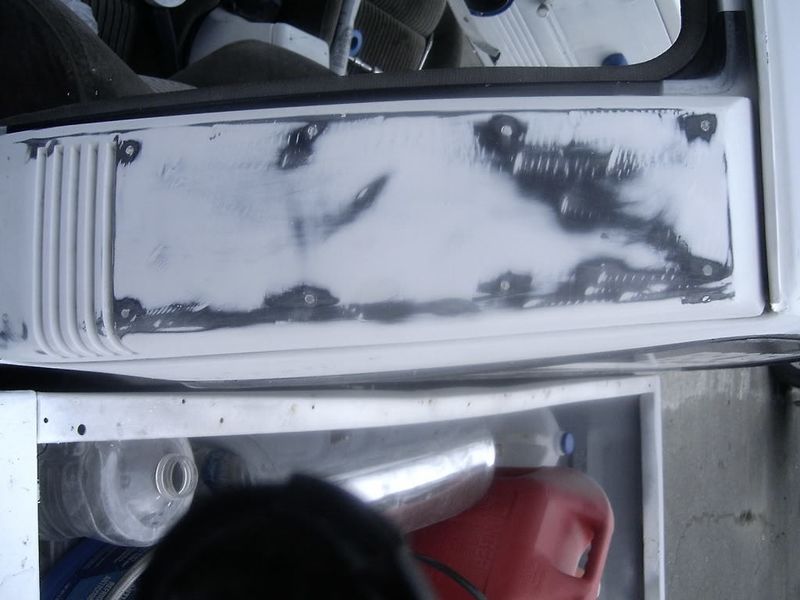

Does any body no how to remove these with out breaking them. Its the long black pieces on the cab right behind the door.
tucnrim's avatar
tucnrim
if it is a single cab then those come off by unbolting them from the inside of the truck. there are round hole plugs you pop out and then i believe it is a 10mm deep socket to get them off and on. hope this helped ya out.
added a pic, you mean these right?
if so then like i mentioned above.
duneracer69
ya man thats them thanks they are kickin my butt....lol
