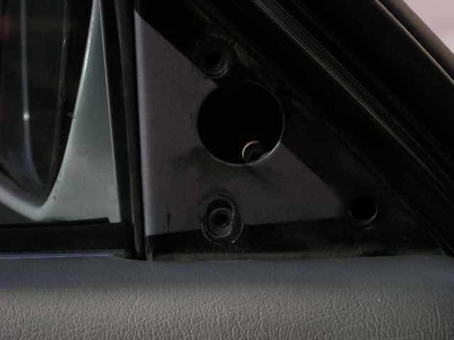

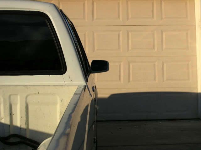

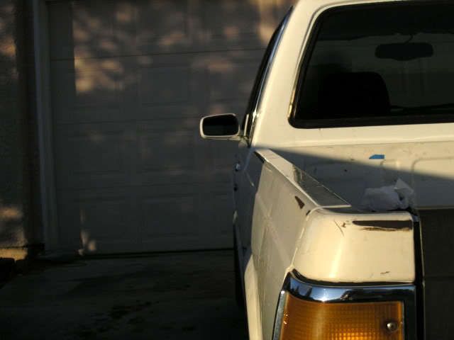

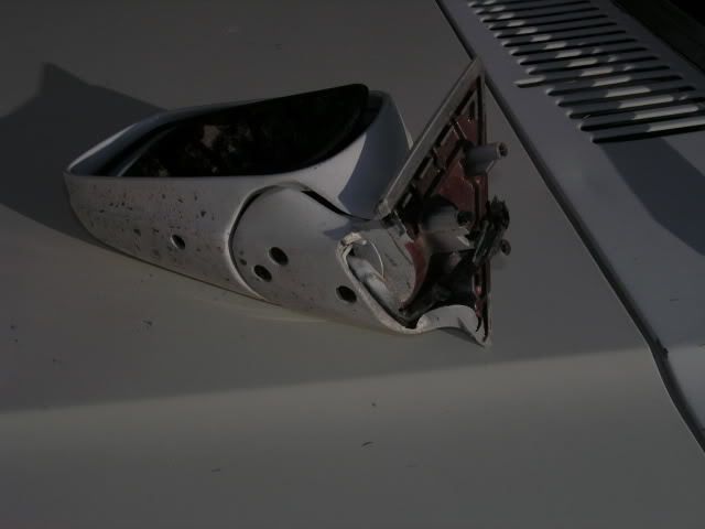

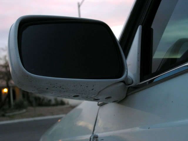

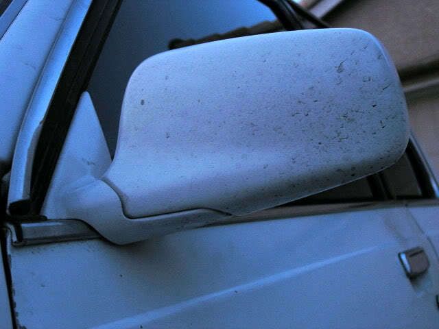

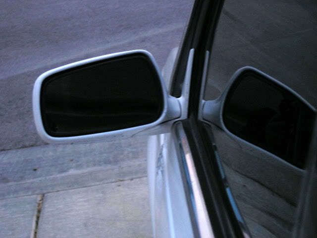

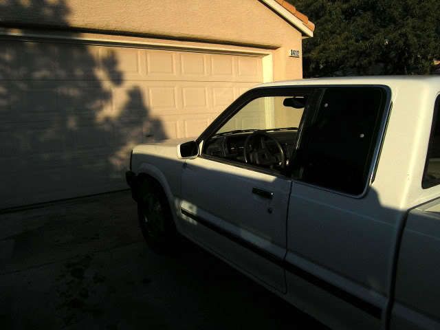

I don't know what kind of write up you want, but I did these mirrors from a 90-94 Protege.
Obviously, had to modify them.

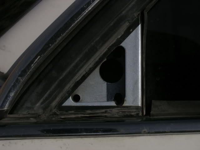

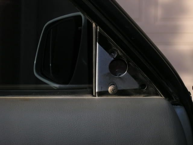

Here are some shots of the underside where I had to remove some material.
You also have to oblong two of the holes on each door.
The top lines up just fine... but both of the bottom holes need attention.
The front hasn't been done yet in these pics.
... and the outside needs this done for the bottom rear hole.
I really like this look.
