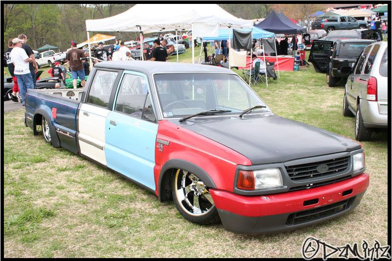

crazyminis
look into renting fender rolling bro, you can find them all over craigslist. I definitley should have did it to get my rear wheels to tuck but i just got frustrated and started cuttin like a maniac lol. but if your wanting to go cheaper than that taking out all of the plastic bullsht in the fender wells, taking a baseball bat and sticking it between the tire and fender rolling it back and forth. it flared my enough to quit rubbin the tire.
here's some video's
