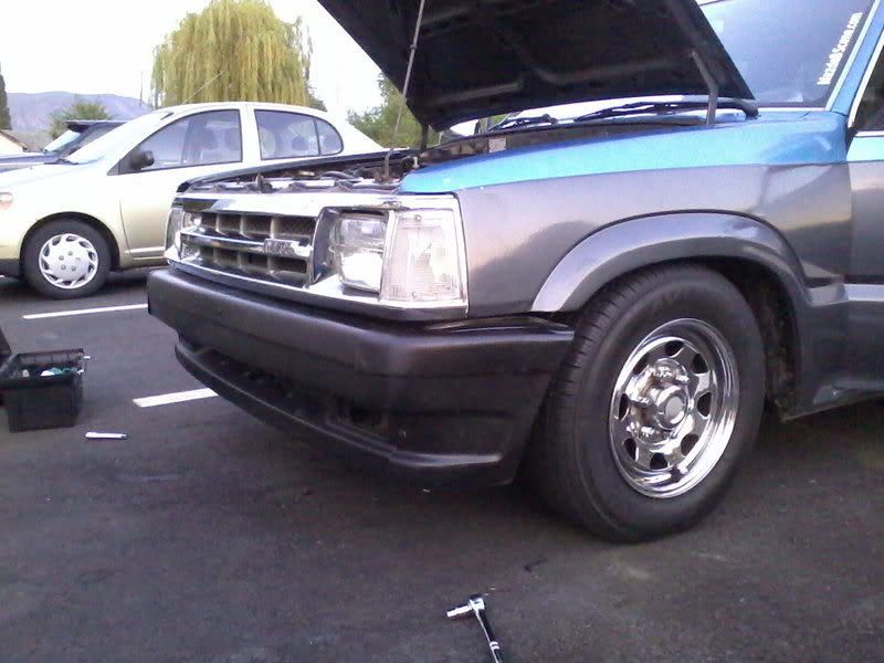

So im having trouble getting my stock front bumper to sit properly. Are there any tricks i should know about the horns on the sides of the rad support that the end caps slide onto? How do i suck the end caps up closer to the fenders?

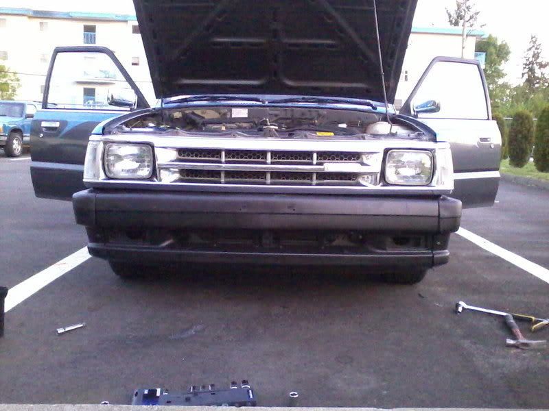

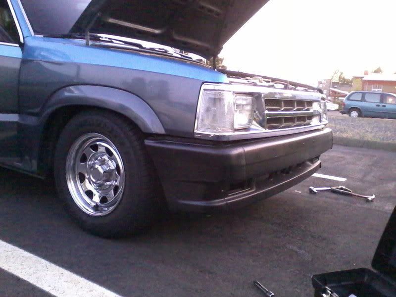

i took it all apart today and replaced a few bolts and put it back together, this is what i mean by not lining up. any help would be much appreciated.

I'd say go to a pick and pull and get a set of bumper mounts off a truck that the bumper lines up good on. It looks like your truck might have had a little bump to the bumper that tilted it back, which might have tweaked your mounts.
I agree with Juan, that's the standard got bumped in the parking lot look. It sucks people just drive off.
mazdaman82's avatar
mazdaman82
yep^^^^ thats what it looks like to me as well
Your bumper is bent up in the middle man. That pulled your mounts in toward each other and made the ends sag

so ive already got a chrome bumper waitin for me at lordco, if i just get new bumper brackets will that fix my problem or should i get new end caps too? im pretty sure my valance is fine.
