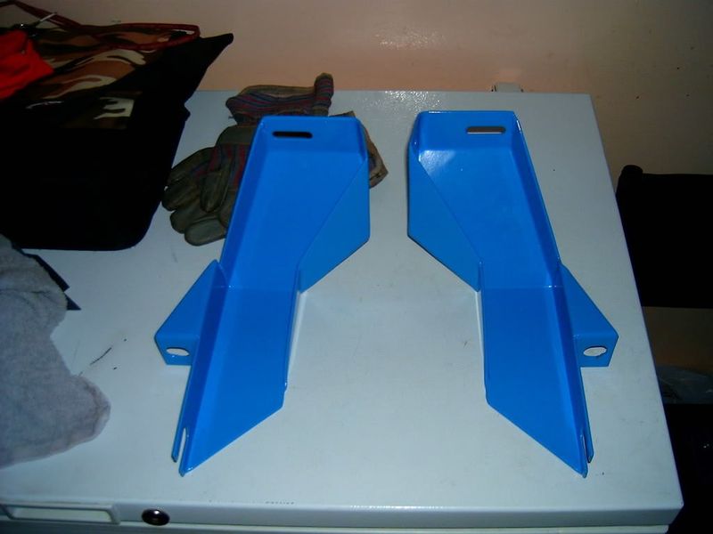

ya so when they are done and you paint them or powdercoat them they will or should look like this when done.
I bought these a while back and got them powdercoated but I build them now so the bumper fits tighter to the front of the truck.
