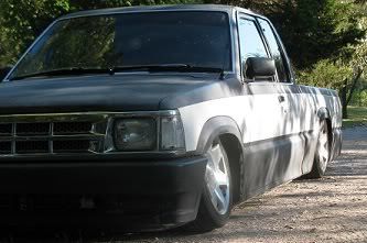

heres my camber and the escalades had a blow out and bent the shit out of one so figured it was time for new wheels
bagdb2200
These are 8" wheels with a 25mm offset. In the back it looks like they fit in the 4wd flare if it doesn't go up past it. But there's no way it will fit with 2wd sheetmetal unless you flare the bedsides. The front you can see how they fit with the camber.
I have the same wheels on my truck but it's no good to use for reference because I narrowed the front control arms, and have a narrower axle in the rear.
