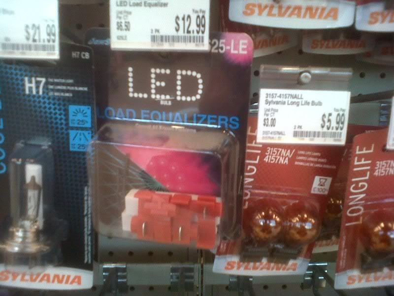

Let me get to work today and ill get you a part number and pic of the package
mazdawg(mikey)'s avatar
mazdawg(mikey)
So its $12.99 for the pack of 2. They are called load equalizers part #625-LE

Yep, that's the exact thing I am running. Work great.
