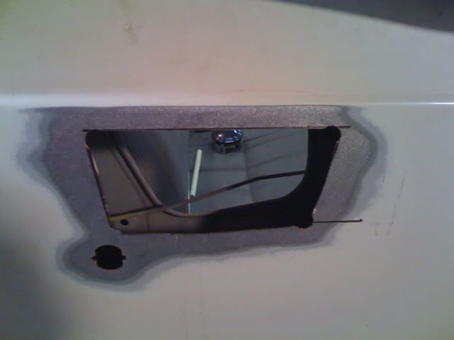

here's some pics of when i did mine.
DO NOT cut out whats there of the handle like i did, warped the shit out of the skin, lots o body work after
here's what you need to do with tacks, but, fill in all the voids or it will crack later
before long, its all gone
