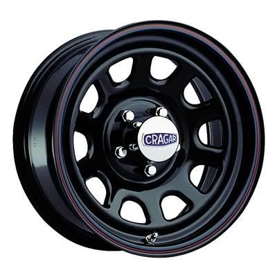

well, i went ahead and ordered just ONE cragar d window wheel in a 16x8 +12mm offset. i ordered just one because if it ends up not fitting like how i'd like, i don't want to have to pay the shipping to return ALL of them. however, if they do fit, i'll just need to order 3 more lol. i'll report back i suppose.

haha yup. i got the one in. it fits PERFECT (imo) so i went ahead and ordered the other three. it sits ALMOST flush with the fender, just pokes a little bit. with a nice 205 tire it will sit great. might have to roll my fenders a tiny bit but should look sick. here's a picture of the wheel itself mounted (don't mind my ratty body. it's a work in progress.)

word, yeah the 16x8 cragar 'd' windows i got have a 5 inch backspace. thanks for the food for thought. i'm not super worried about tucking though, just going for a rat rod/old school look.
