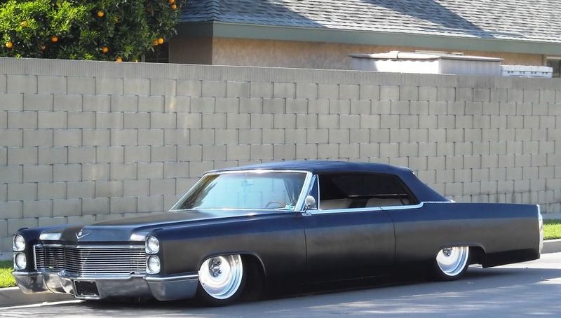

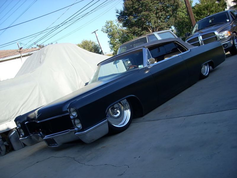

Hotrod Flatz is a good way to go, but I wound up using 2 part epoxy primer sealer on my Caddy. It seals the metal and is good as an undercoat when you paint it. Mine has been outside for two yeaers and still looks like the day I applied it. I am very ready for a shiny paint job though. I am burned out on the flat look.
