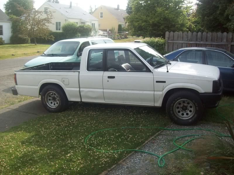

will these "FACTORY TOYOTA CHROME RIMS 15x6" fit with or without modifications?
woz943's avatar
woz943
I have seen these on a Lexus but haven't seen any mazda with them.
crazymikey's avatar
crazymikey
Yes,those Toyota rims will bolt right on.
