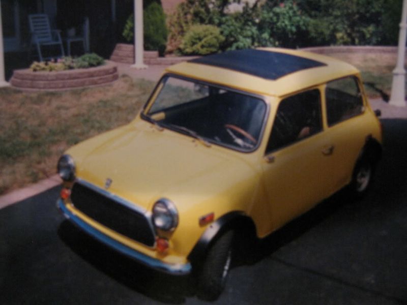

crazymikey's avatar
crazymikey
The one in my Mini was a Webasto
