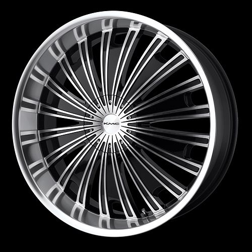

What all needs to be done to get a 20x8.5 38-40mm offset wheel to tuck?
Do you have to have 4 wd sheet metal, will there be any big issues while turning, etc...?
Also I am supposed to be looking for a positive (+) offset right?
Here's an example of what I'm looking at.
20x8.5 6x5.5 38 Black/Machined Lip

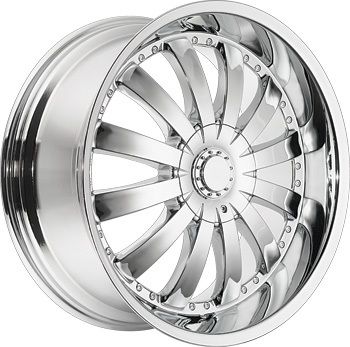

Also just found these...they can be ordered with a 110 center bore, reading it looks like the mazda is a 108, I'm assuming that means you wouldn't have to modify the wheel or the hub?
6x139.7 +38 Offset $250.00/ea
Center Bore: 110.00
