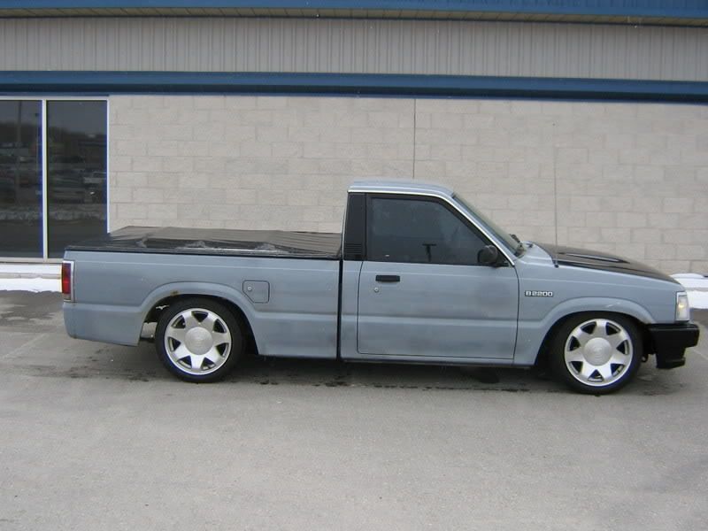

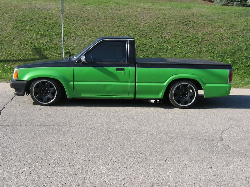

Difference in tires. First pic with the primer is with cranked torsions and flipped ball joints. 2nd pic is with drop spindles installed.
205/50/17
205/40/17
