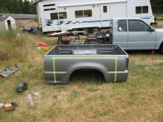

OK so a couple of weeks ago i had this idea that i could cut some half moon shape holes in the side of my bed so my tires wont rub on the finders and then the sawsall went wild and cut to much so after a long line of yelling and kicking crap i went to local junk yard and found a bed well this bed i found was for a regular cab 4x4 which will not fit not know this and already paid for it i was up a river with no paddle so i called 20 or so other junk yards and they did not have the extended cab 4x4 bed i was looking for so on to plan B and this is were we are now

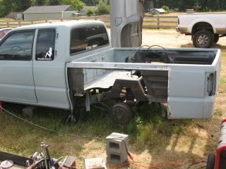

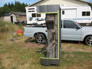

OK here is the start of the project the driver side of the bed ya thats a big hole

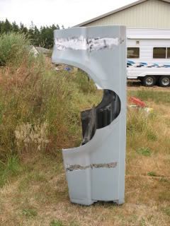

after making all the measurements we needed we taped it off and cut it out with a cut off wheel no sawsall for us any more
clean cuts!!

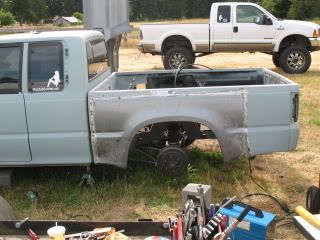

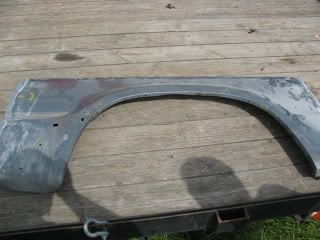

This is the new skin going in all cleaned and ready

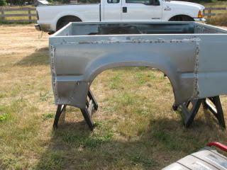

did the same measurements on the bed on the truck so it looks good

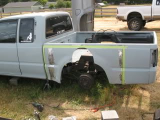

bam look at the hole nice and clean tape is the best ruler when cutting long lines

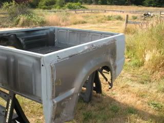

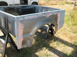

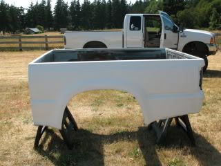

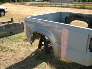

ok the new skin is in place now tak it in slowly
ok well this was a big project but we worked as a team and its almost done thanks to suicide for all fitting man
