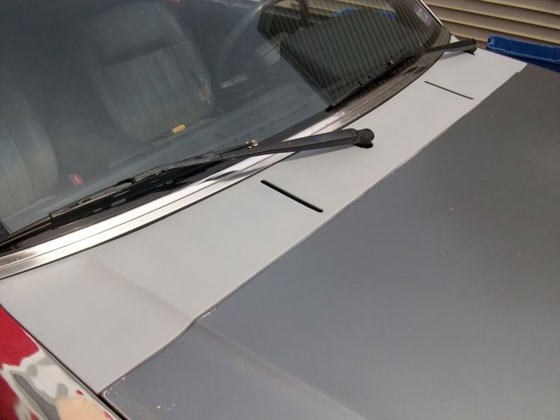

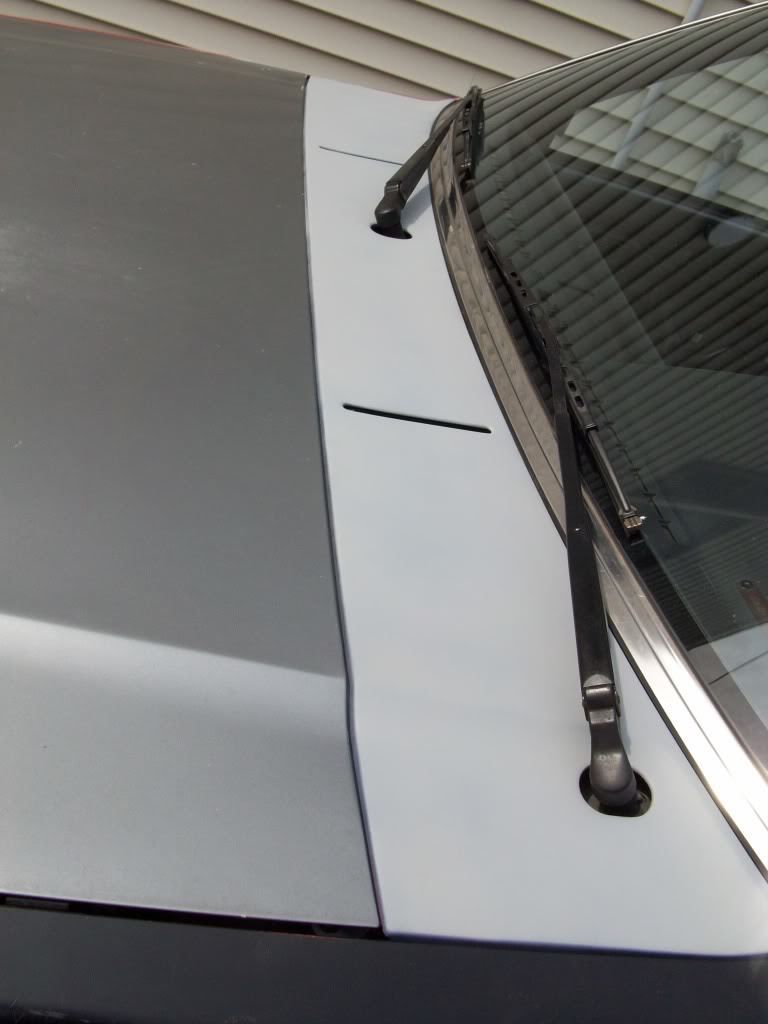

minituckin
Figured I'd share some pics with you guys... I left to two slots for the window squirters, since i drive my truck daily and alot of highway driving, the squirters are very usefull...
