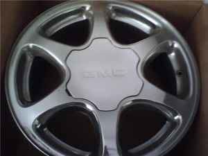

any body know if these will tuck on 2wd sheet metal i wanna buy them for 100.00 bucks for all 4..17inch yukon wheels. I know i have to machine the hub circle to fit around the tabs but i wanna know width..

Yes they will tuck but you will need to roll the rear fender lip a little.

cool man will any stock gmc rim fit our trucks and tuck??? thae are some other ones on craigs list for 50.00.. these

make sure you get some lower profile tread after you get the hub machined out to the 3.75in that the mazda hubs are... i have 16in z71s that im runnin 55 series on and i didnt rub after i rolled the fenders... im not bagged so i couldnt tell you for tuckin purposes...
