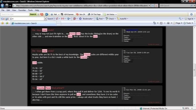

I got a 1990 mazda b2200 what year rearend do i need to do the toyota rear end swap???? What year, size, gearing??? anything else i should need to get to do this swap.. keeping the 2.2 engine and trans... do i need a new drive shaft?? i dont know anything about this so any and all advice and links would be great...

Search feature is a wonderful thing. . . I searched, and halfway down the first page. . . .

get a better computer. i've got a 69 yota axle and its 54" WMS to WMS

oh, and you'll have to change the pinion flange on the driveline. likely you'll need to change the length too.
