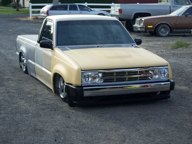

did any of you guys use the blinker lights? if so how did you guys wire them?? i noticed that theyre also running lights, am i right?
dragginmazda86 (dave)
Since I have shaved corners and no more turn signals on the lower valance I'm using the bulb in the ranger light for both park/turn signal. I'd have to look at my harness to remember which wires i used.
808hawaiian's avatar
808hawaiian
did you use the ford harness and splice the mazda wires into it? like running lights and blinker lights?
Yep, I got the connectors and bulb sockets with about four inches of harness off a ranger at the junkyard. Then I just soldered my mazda wires to it.

so im guessing solder the grounds from blinker and running light together?

why does it look like your bed doesnt line up with the door? just curious if its camera tricks or if its really like that...
^^^ no camera trick, when I backhalfed the truck I set the bed mounts a little low and when I took that photo I didn't have the shims in between the frame and bed in there. It sits level now with the shims.

ok... so thats how it was but its been leveled... cool... ive seen the cameras play tricks b4... like dragula? the b3k rat rod project... was LH drive... a few pix showed RH drive...
