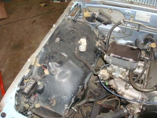

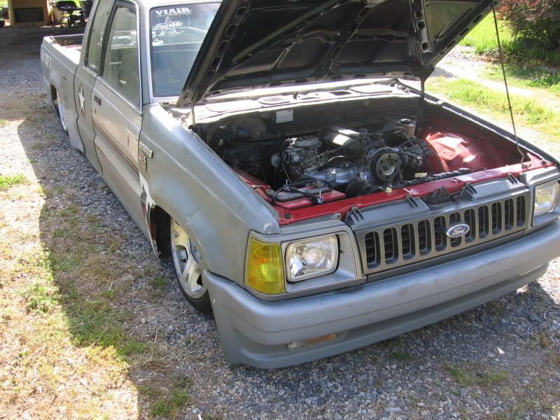

Yep thats him here is a pic
dropped90(justin)'s avatar
dropped90(justin)
and it turned out bitchin too.

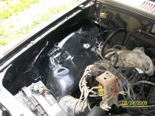

mazdawg(mikey)'s avatar

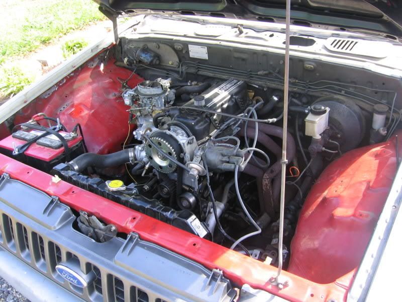

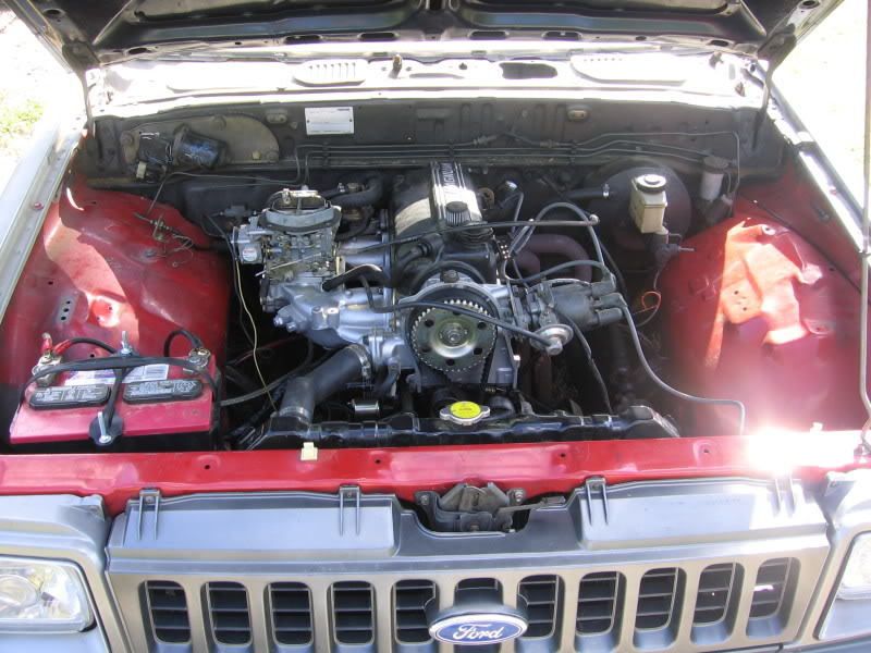

here is my truck with raised stock inners and it was done back in 2000

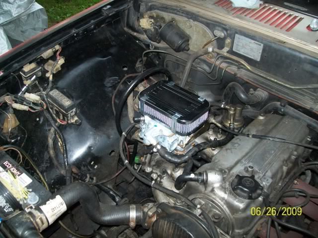

Those are sweet mikey and 3day!! Thanks for everyones replys. I'm going to tackle this on mine in a few days for one its a cool mod and two i don't have a webber yet and this way i can hopefully run all that tangle that goes with the stock carb.

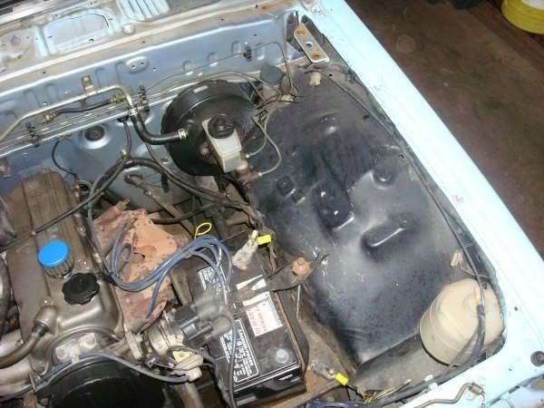

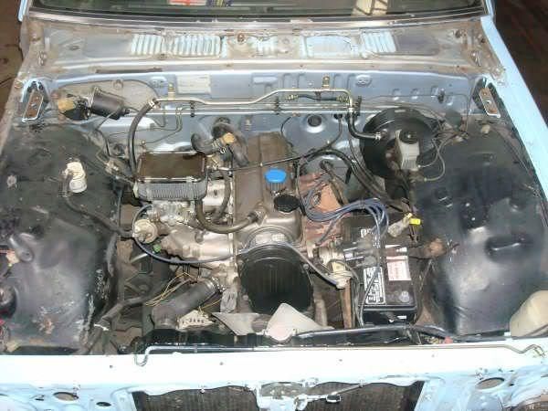

one down
didn't want all that stock crap in the way so i got this

That looks good, whats involved to make it happen? Do you just cut a little off of the top and slide it up?
iculookn42's avatar
iculookn42

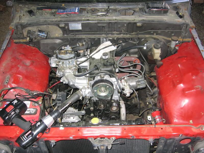

Thats basically it man!! Cut it loose from the fire wall and core support first. Make one cut all the way across the top. Raise the fender to the desired height and clamp into place. Mark the fender from the single top cut. Remove and cut fender on mark you just made that way the top has the same or clost to the same cut to realign with. That is how i did it in a nutshell..... If you look in the upper right corner of my second pic you can see my top cut..
