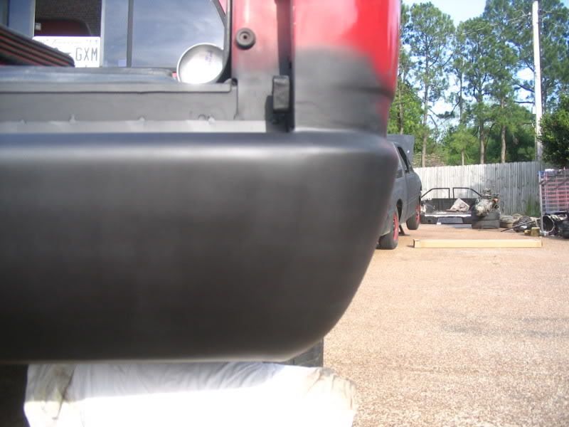

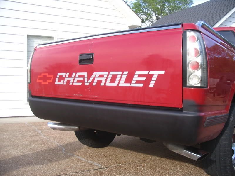

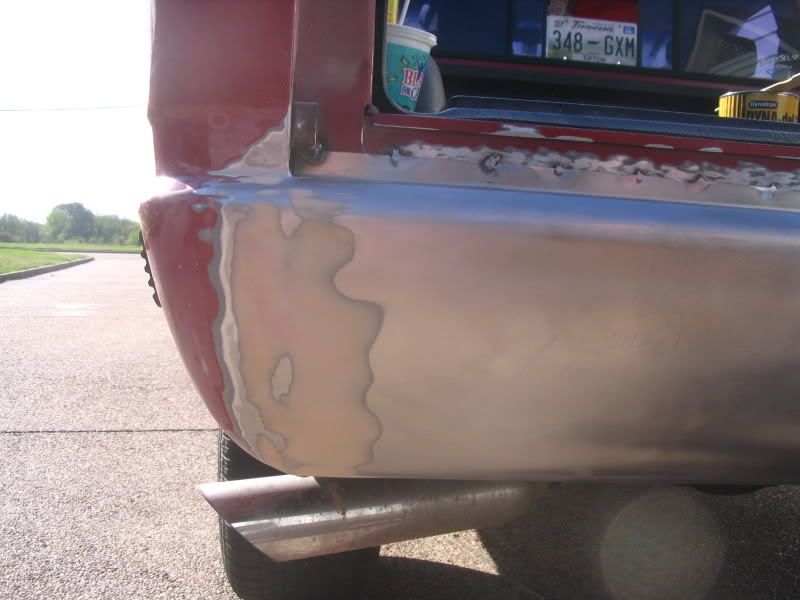

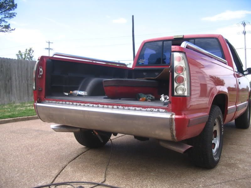

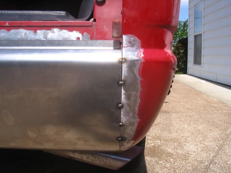

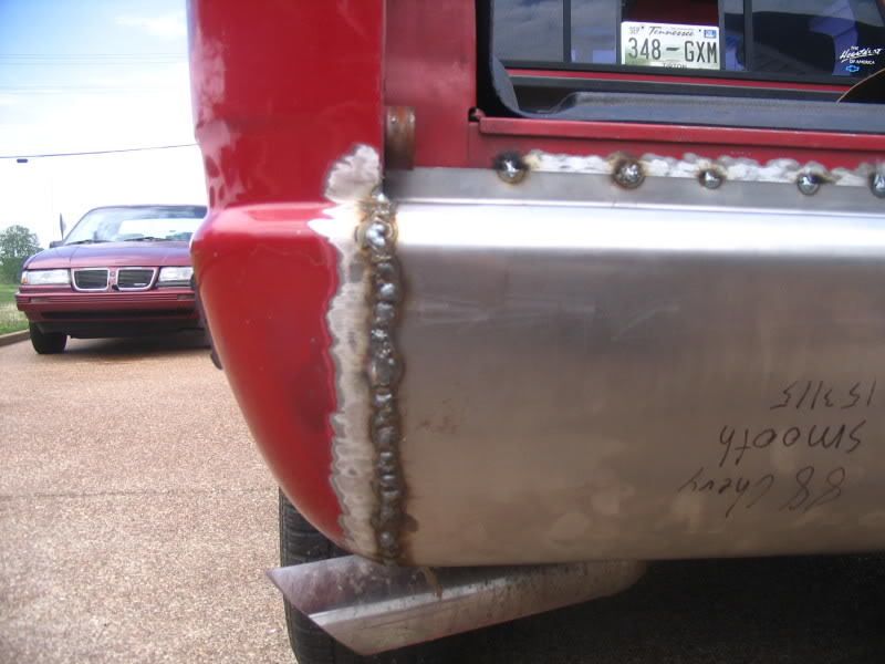

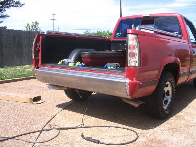

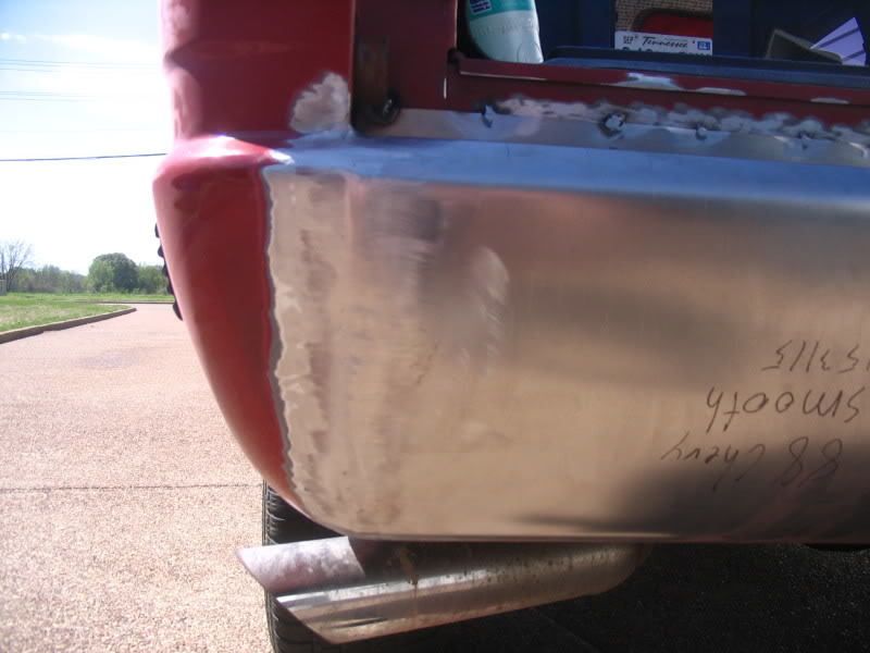

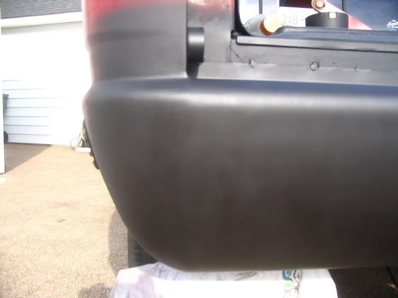

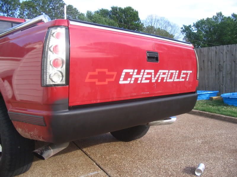

I put a rollpan on my buddies 95 Chevy Silverdao. . . I know i know, big whoopdeedoo. . . But I took pics so I could share. . I take pics of all the side jobs I do so I have records
I've been tryin to get him to customize his truck for forever and he is finally wantin to do stuff! So we did the rollpan. . Next is shaved tailgate and tag in the gate . . He's gonna remove the bed rails, and side molding and hopefully get rid of the euros. . solid back glass. . And most important. . DROP IT! ! haha. . Here's the pics though. . .
-Josh

NIce clean work man looking nice

now he gotta clean those tailpipes! LOL!
Seriously though...nice work! I so wish I had a good welder and some of my tools back.....I could be getting so much more done
Nice work man! I really like how you kept the gap between the tail gate and pan right on all the way through, so many people don't do that!

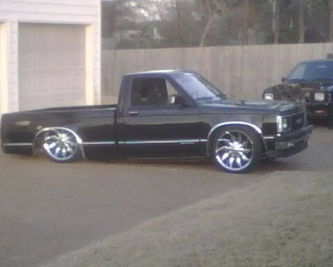

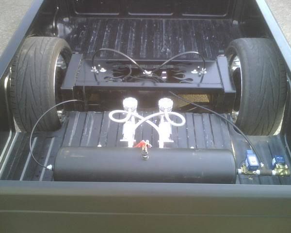

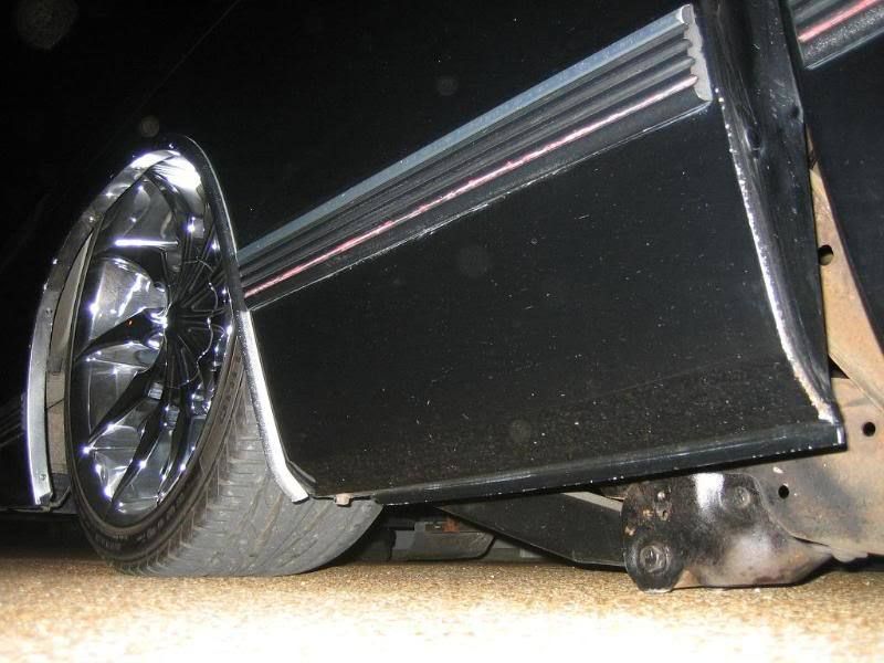

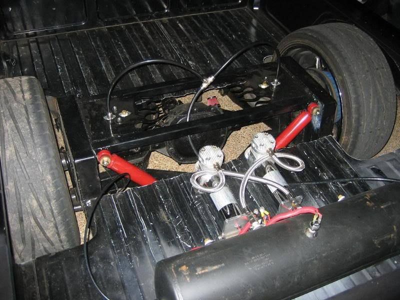

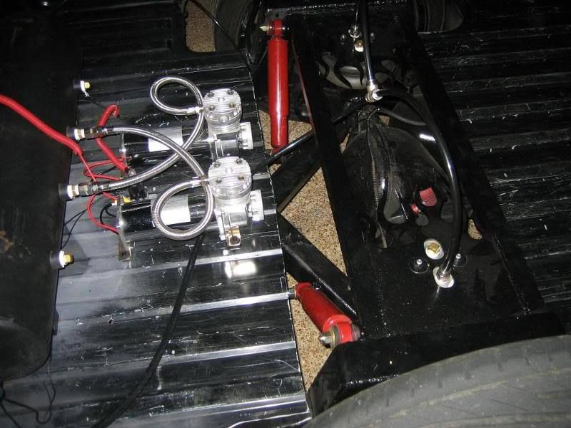

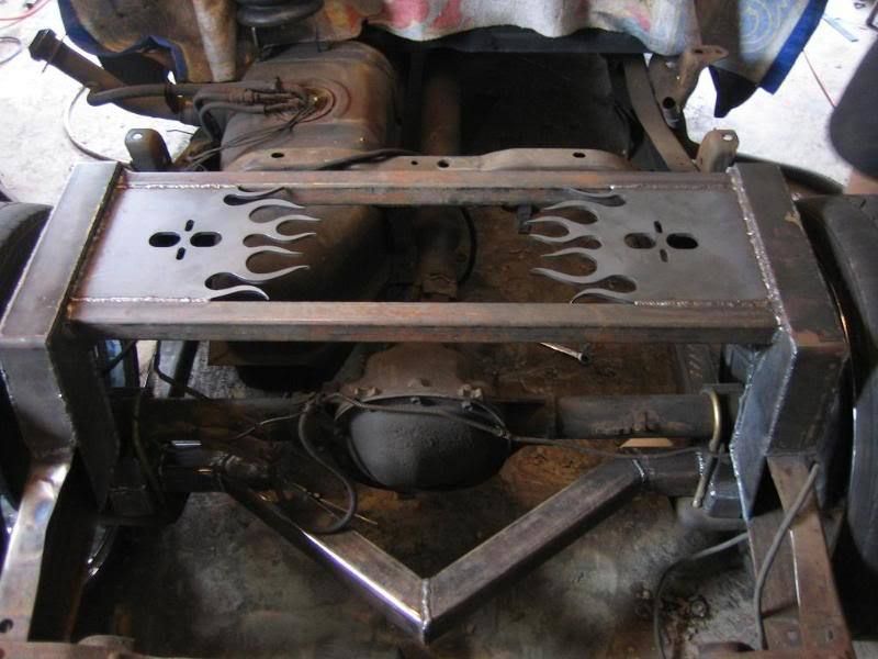

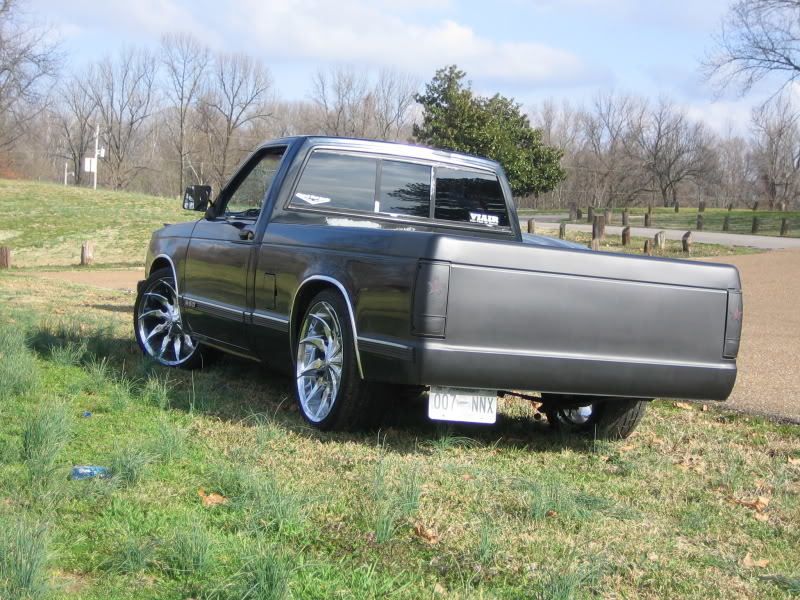

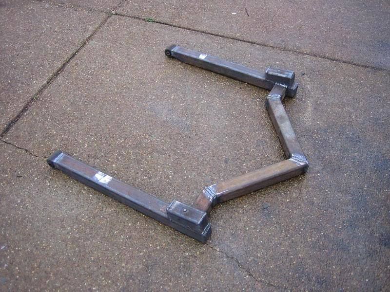

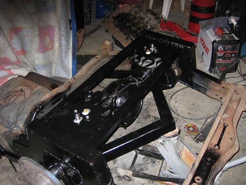

I dont have any pics of the 86 I jus worked on. . But i jus dropped it and shaved some stuff. . But I bagged my buddies 92 s10. . Well the back. . then he sold it. . But here's the pics of it. . It was the second rear end I had bagged. .

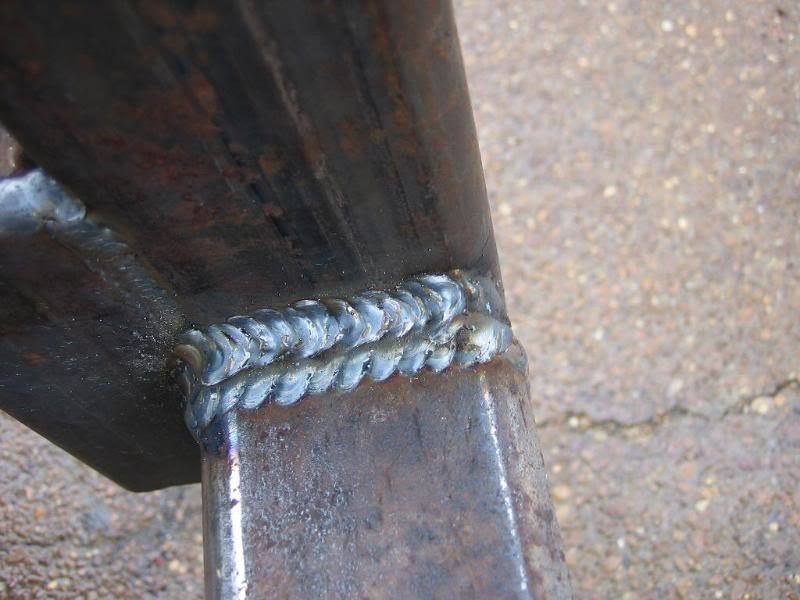

And I put the skin on. . .
And on of my favs. . Makin cops hit their knees
-Josh

looks sweet! a few suggestions though, those shocks angled like that arent effecient. theyre MAYBE using 75% of theyre damping abilty. next time have them straighter up and down. also mount the shocks with the bushings running parellel with the rear end, the bushings will wear out quicker mounted in a bind like that especially with a 2 link pulling the axle back and forth. oh and 2links= goo! haha. just a couple tips that might help you in the future! looking good man.
bodied b2600zx (josh)
Im well aware of shock efficiency issues. . They worked fine. . Not my truck anyway. . Jus how he wanted it done. .

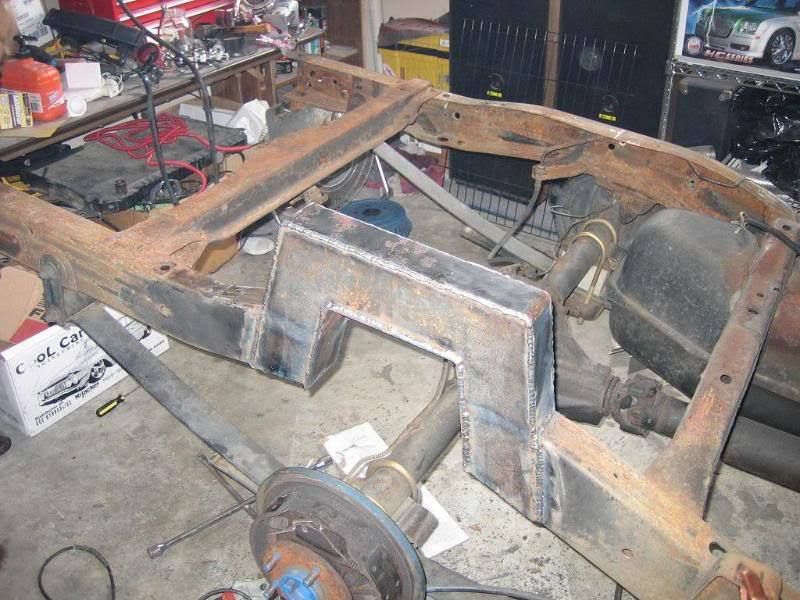

And dont get me started on 2 links. . . Theres nothing wrong with them if set up right. . and with 8 inches of travel, the pinion is not gonna move enough to matter. . . The 2 link I made was jus fine. .
