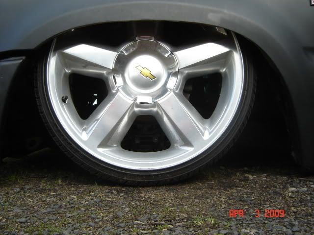

tuckin20s
20X8.5 chevy avalanche wheels fit with 4X4 sheet metal and NO drop spindles.

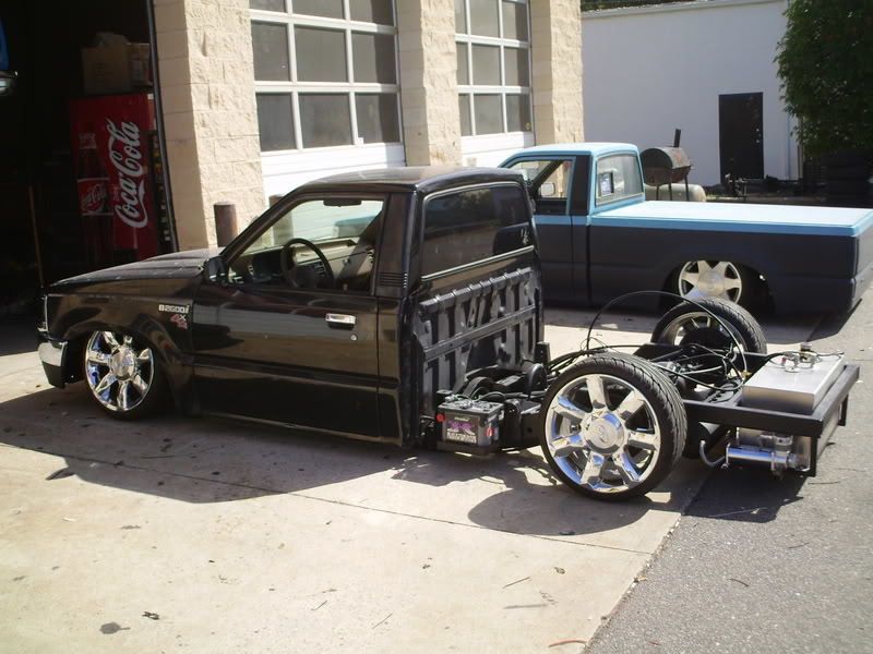

99-2000 Escalade 16" on my 92
Lincoln Navigator 18" on my 90
Infiniti QX56 18" on my 92
Escalade 17" on my 88
Z71 16" on my 86

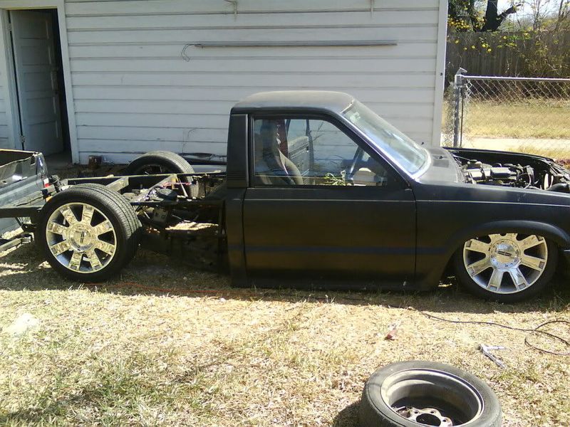

90-b22dawg [andrew]'s avatar
90-b22dawg [andrew]
2008 18" Linclon Navigator rims, they have to be redrilled to mazda lug patter 6 x 139mm
ls1ftw
Ok I like those Avalanches, I am lookin at some 20s that were on a 2003 silverado they are 20x8.5 with a 14mm offset and a 5.2 inch backspace. Would these work on my stock height 2wd b2600?
