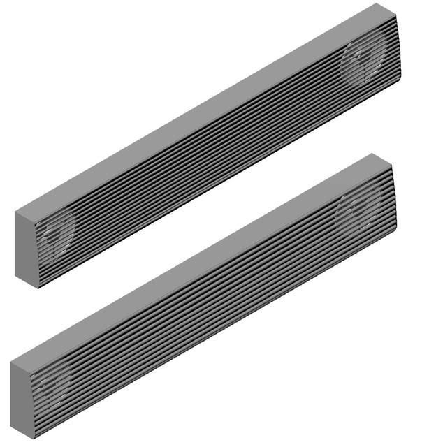

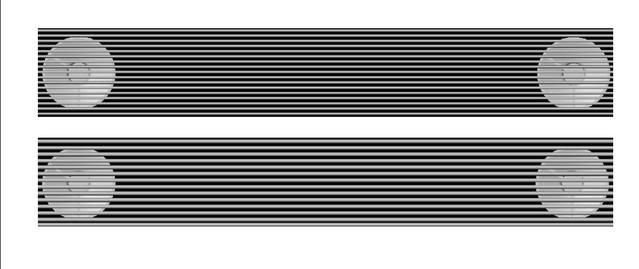

i saw that thread from linn. i'm gonna weld weld it. dumb luck for me, my buddy has a welding company, and i do 3d cad drawings at a machine shop. thats why i asked flat or round. in my head it would be easier to make with the round. here's a couple 3d models of round, just to see how "transparent" different sized bars would be.
the reality is that the flat is going to look better. when i get a chance i'll draw that, 1/8" x 1 flat.

Most of the billet grills I have run across have been made out of 1/8" x 1" aluminum strips. Don't know why, but figured why mess with a good thing LOL. Good luck on the build. Hopefully one of these days I will get a phantom grill built

my buddy made one out of like 1/4" or 3/16" round stock for his 78 bulletside. it turned out pretty cool
i vote for round, cuz like someone said above^^ every one has a phantom made out of flatstock...
lowered_impressions
1 inch i think is too thick, no room for lights
