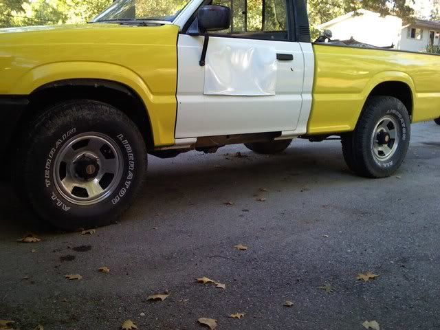

i have a mest up rocker on the driver side, my truck is bodydroped i bought it like that but it looks like they went over a speed bump and stop and slammed it right over it on that one side, i have a spare truck to take the other one off but i want to know if anybody else done it thanx

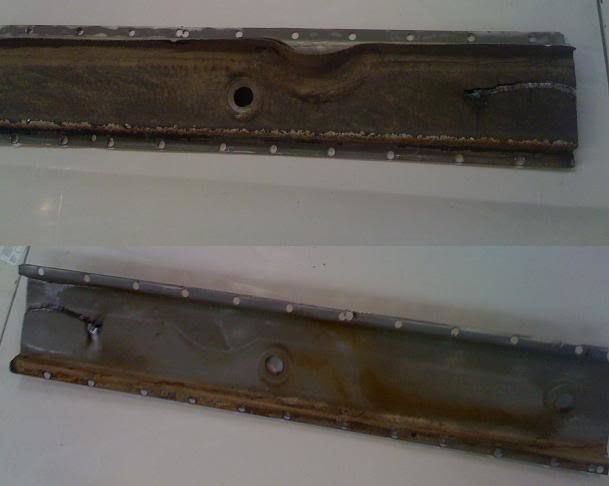

i have not done it yet, but i have cut one out of my doner truck. maybe seeing whats inside may help.

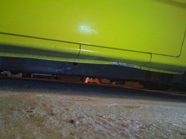

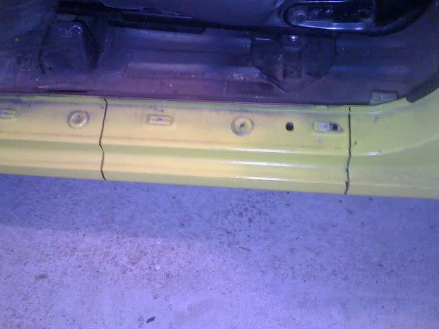

mine is from falling off a jack
i'm gonna cut out the marked piece, drill out the spot welds, and the rest with a cut off wheel.

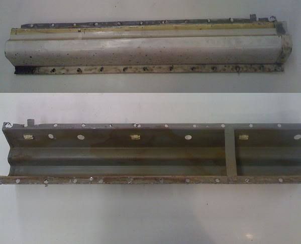

here's the piece i cut from the doner after i drilled out all the spot welds, outside and inside rocker
weld up the holes and the butt weld the seam.

thanx those pics help me out gives me a great starter plan
