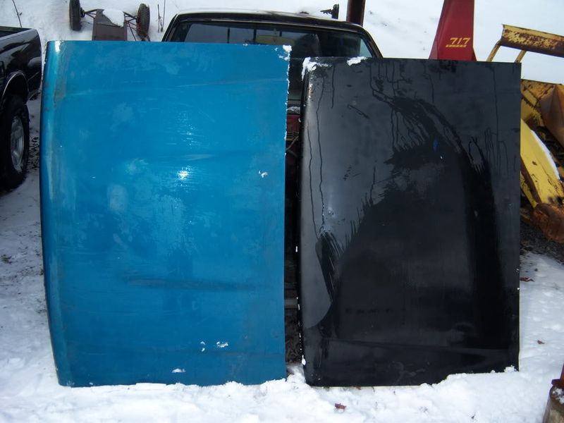

ls1ftw
anyone have pics of the difference in hoods?

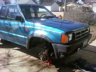

seanzy1105
Bubble hood on my 2600i 4x4
bgdb26k
my bubble hood 93 b2600i
