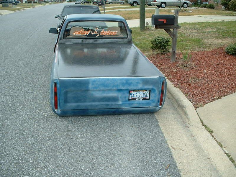

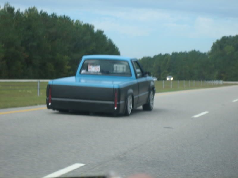

You will need some diodes or a trailer wiring adapter to make the turnsignals to work properly.The mazda uses seperate bulbs for brake and turn signals whereas the caddy lights use the same bulb for brake,turn,and parking light. I have installed them in two of my trucks.
