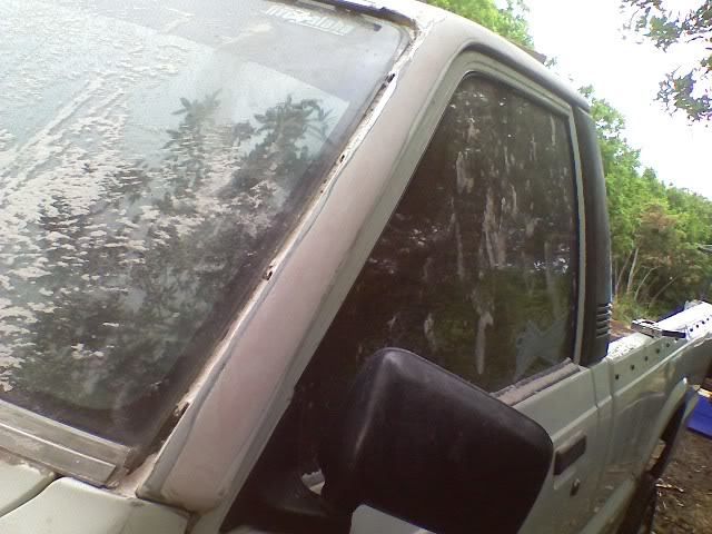

has it been done i filled in the gutters above the doors

i filled them in with bondo and smoothed it out

i only did the driver side becuz it took me all day and used solid bondo i will probably use a lil plastic to help fill the other side and it makes it look really clean

Holy future cracking bondo horror!!!!!!!!
Bondo continues to shrink over time, and is not to be applied over 1/8" thick, because thicker applications will shrink and crack and most likely fall out. you might as well dig it out right now instead of having to do it in a year or two once you have spent money painting it and it gets ruined.
bridge between the roof and the gutter with sheetmetal the way you have with the bondo, then use bondo to smooth the minor imperfections.

im with fattirebicycles. its going to crack really bad on you.
