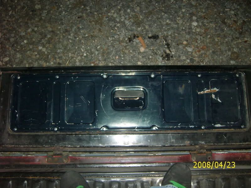

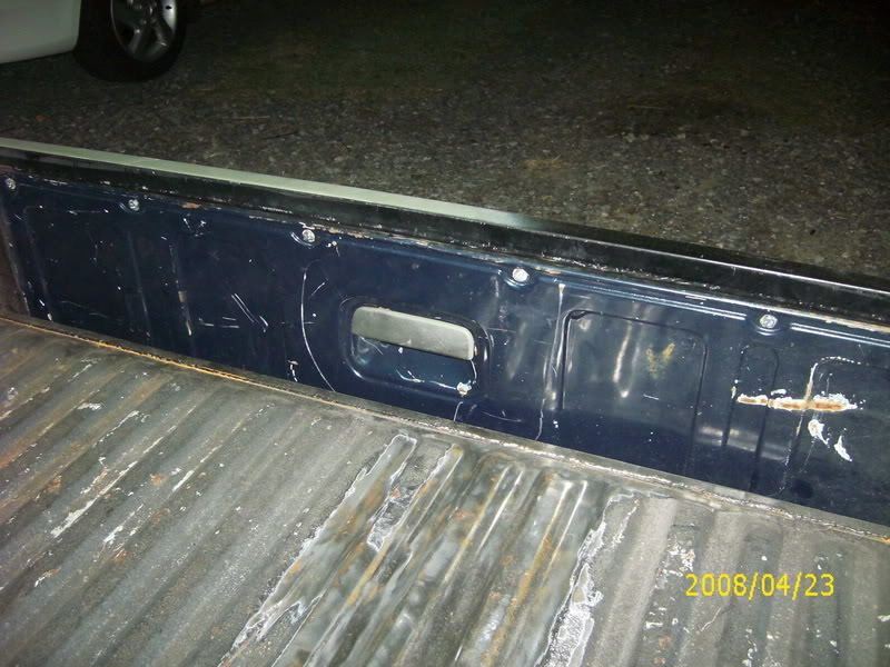

i got an inside panel from a friend. he cut the outside section out of a tailgate around the handle and welded ito the panel and smoothed it. ill post some pics tomorrow when i get some light.

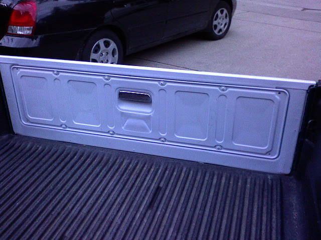

ok i just snapped some pics tonight so the quality is crappy with the flash and stuff. now keep in mind that he had it just sitting around so ignore the scratches and stuff. i still gotta sand it down and primer it. i wanted to make it fit and work first. it fits perfect even with my floor being raised 6 1/2 inches.
