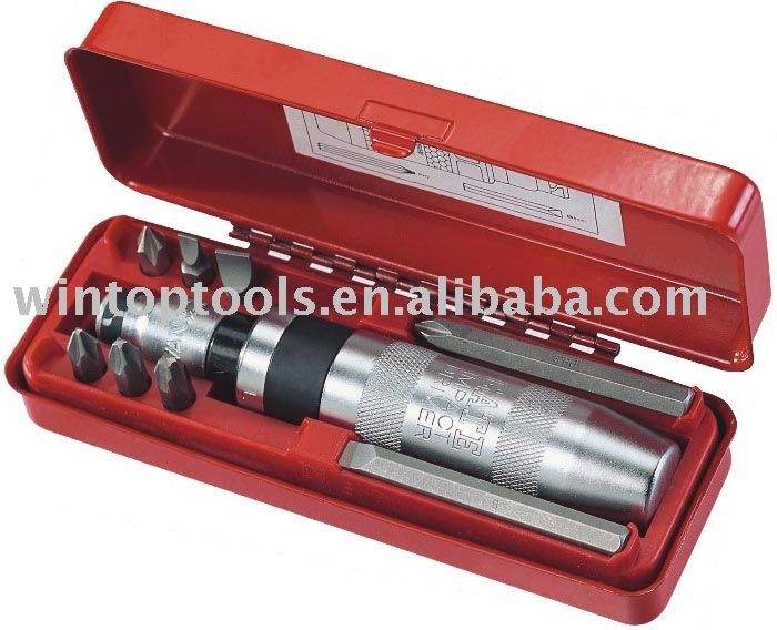

any ideal how remove them damn phillip's heads screws??? there in there good
pont's avatar
pont
beg barrow or steal (joking about the last one) one of these
its called a impact screwdriver
jmzcustomz (jeff)'s avatar
jmzcustomz (jeff)
Those things are godsends on rusted, and stripped screws!!! A tap of the hammer and voila!
elbine69's avatar
elbine69
Yup impact driver. Only way to go.
dropndragmazda's avatar
dropndragmazda
thanks guys I got them off
