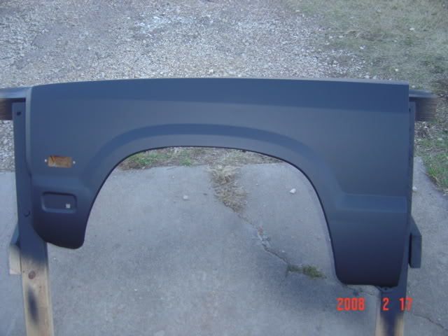

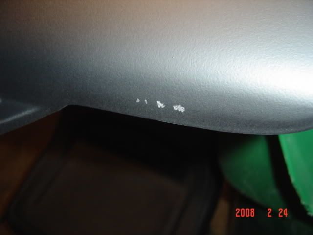

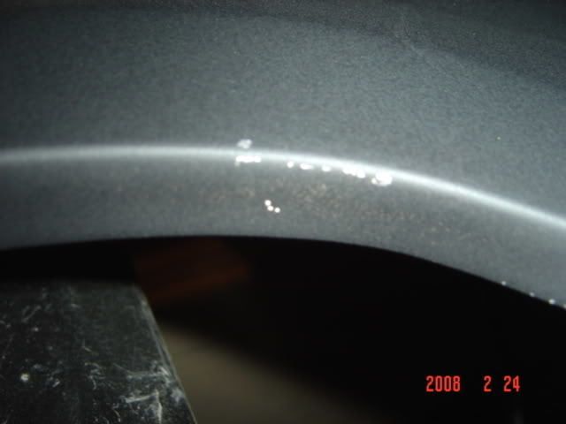

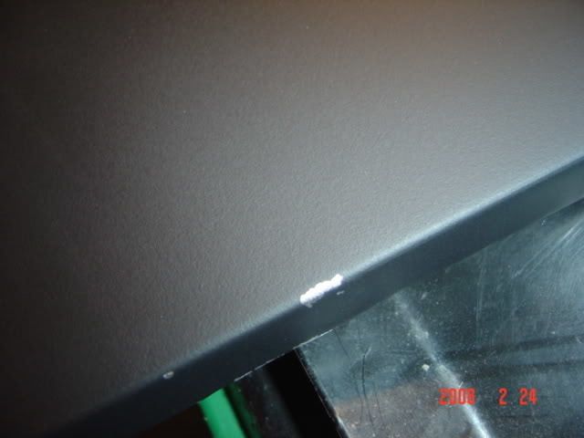

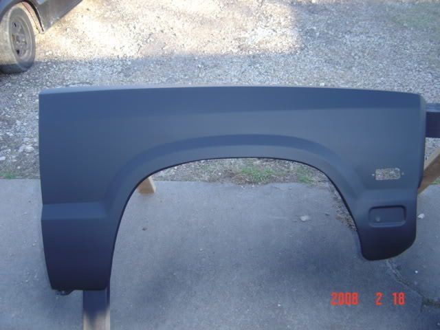

i painted my fenders about a week ago and i had a big problem today. i went to put my emblems on and i was using tape as a guide i first tested the tape on the lower part of the fender and exactly what i thought but didn't want, happened. it peeled the paint off. WHY? i sanded with 180 grit and cleaned the surface with degreaser. the paint says to use 2:3 with the approved thinner so i mixed 2 parts paint to 3 parts thinner. now the paint was coming out of the gun pretty shitty but looked badass when it dried. and it isn't coming off everywhere just on certain areas. any ideas?
oh and this is just a cheap hotrod black primer that i bought at oreilly auto parts. don't know if that is my problem but it could be.

sounds like you did not get it clean enough. some pics would help alot

Typically, When paint comes off or peels off, Is because it was "too smooth" In those areas. Not enough texture for the paint to stick

Washing it with thinners or mineral spirits would have helped. If you don't there will be a layer of dust from sanding that will stay on there. Could have been a problem with the paint but most likely prep.
