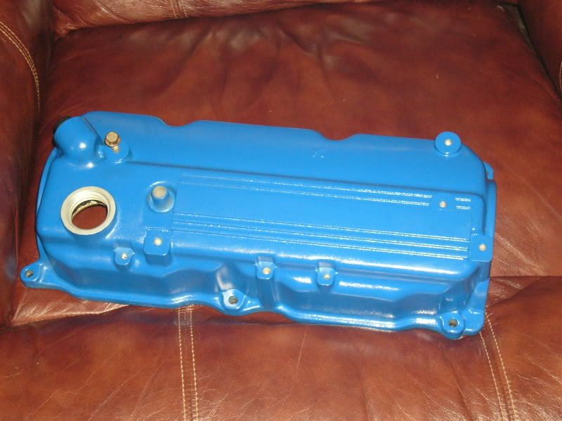

but i bought the elite kit. for $200 and i love it. i used it yesterday amd it waz extremely easy. just make sure ur parts are clean. i had cleaned my stuff in a blast cabnet. and then i used there paint prep cleaner which they recomend. it cleans all the grit,oil,and all resedue off the part after u blast it and what not. i will post a pic of what my part looks like that i just did yesterday.

the pic is kinda blurry for some reason but trust me it looks real good.
