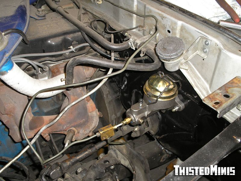

whats the best smallest brake boost tyo add to a b2200 for a cleaner look then the truck has been bodydropped so it can be clear from everything
elbine69
I think the geo metro booster is the smallest. Ive seen it used a few times.
i think geo trackersare the same and will work
blackhulk
i heard of thous and i guess i will have to check into that..thanks alot thou
usmcperez
anyone know what year metro?
slammedyota91
v8 knows i think
twisted minis
Get a 7" booster off of eBay with a Chevy master. They still have the same stopping power as stock, unlike the Metro.
twisted minis
Or go GM manual. Lots of room.
usmcperez
i like that, bout to check em out on ebay, is that a direct bolt on for a Mazda?
doubt it
