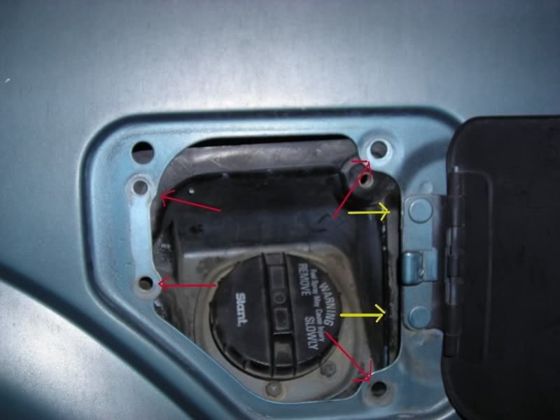

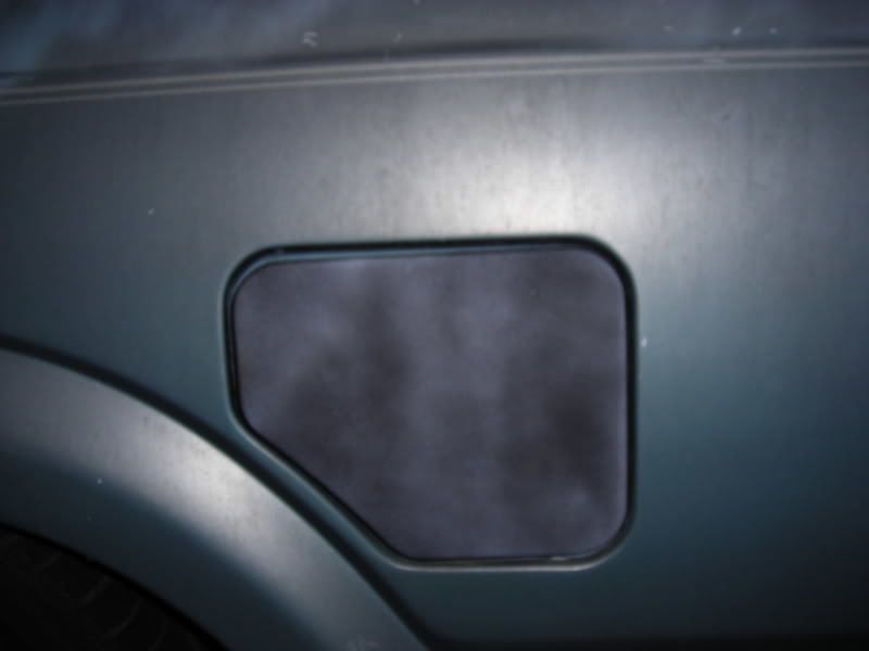

first remove your gas door by removing the bolts the red arrows are pointing to, once they are removed you can get to the bolts with the yellow arrows that hold the door to the bed...

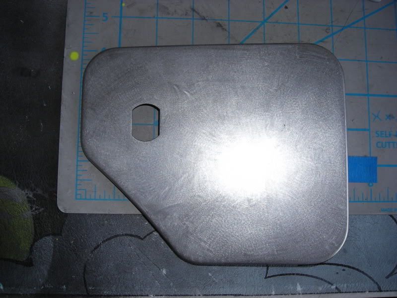

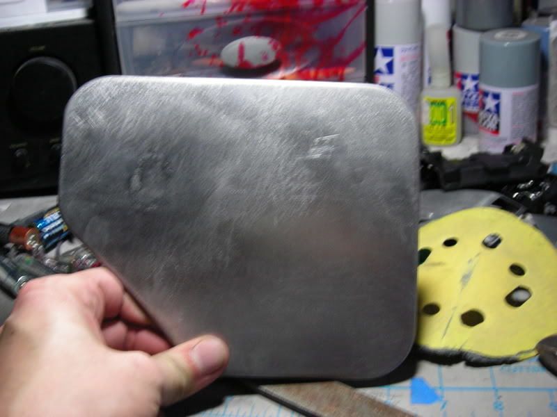

then strip your gas door of the lock by removing the clip that holds it in place, now is the time to get your metal prepped for welding by getting it down to the bare metal and then hitting it with some sixty grit...

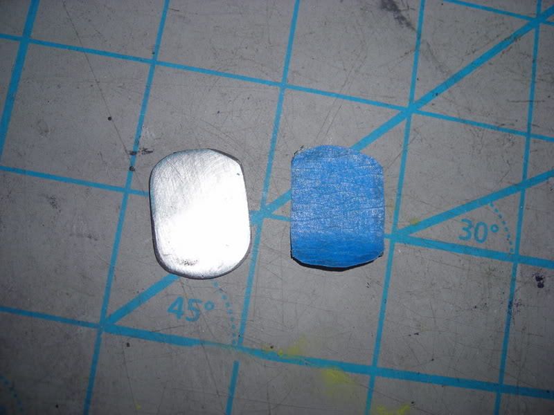

now its time to make a template for that pesky hole, on smaller things like this i like to use painters tape, its easy to stick and trace, and when you go to cut the shape out of your sheet metal you can just stick the template on it and cut...
test to see how your new piece fits...

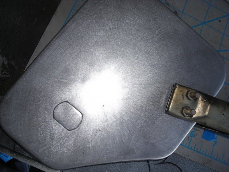

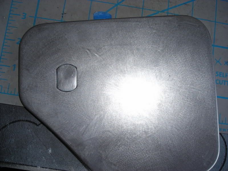

after a few touches with the grinder we are ready to weld...
after you have tacked welded completely around the new filler, taking time to be careful as to not warp your door, hit it with your flap disc on your grinder, it wont take much...
now its time for a coat of filler primer, sand, then a few coats of regular primer...
i thought i had taken more pictures but i think you guys get the jist.

yeah im going to use one of those two position magnets to keep it from opening, its one of those magnets that are on things like entertainment centers. you press it in and its closed, but if you press it while closed it opens a crack while still being held by the magnet.
