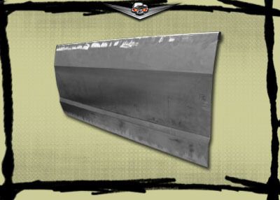

grant doesn't make a skin for the 83s and 84s. i would if they did.
maztang (ryan)'s avatar
maztang (ryan)
they make it for the 77-81, maybe i need to talk to matt.
maztang (ryan)
well i just found that they make a full skin...
but i want the mazda logo and i want to keep my rear bumper. so if anyone can help me out with what i need to do to weld my tailgate shut i would appreciate it.

Im sure grant would sell the skin minus the rollpan, and as for the logo you would be better off to use a skin and use the stock letters welded into that skin. To weld a tailgate in you have to weld filler metal on both side, and there is no way to seal the back side from the elements.
