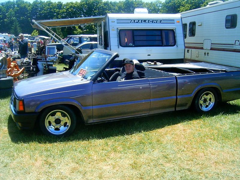

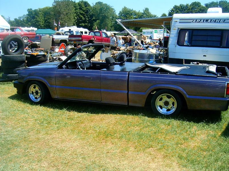

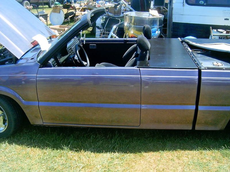

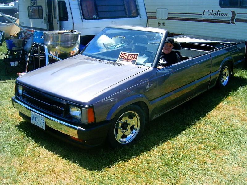

Danm I did a roadster mazda 1 1/2 ago and did a chop top took like 4 inches out of it glass cost abit to replace I will try and find some pics of it.

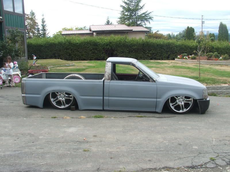

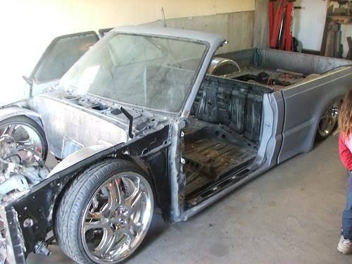

I would like to post pics, as i have tons of the chop, but i'm sure devin would probaly kill me, to keep the windows was alot ofwork, took devin around 100+ hours, needed a second set of doors as well
