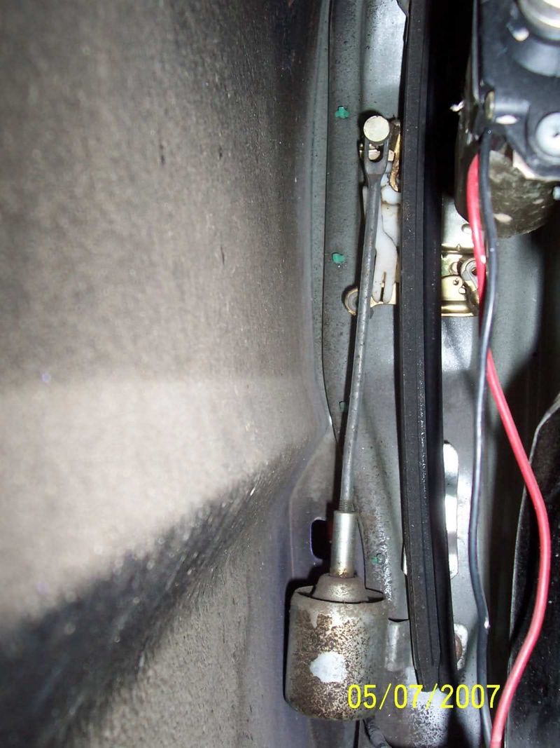

Not sure how the 83 door latch is setup, but on my truck, I used the rod that originally went from the exterior handle, pointed it down instead of up, threaded the end of the rod and the interior of the solenoid I used, then connected them together. The solenoid is actually mounted to the door, directly below the door latch. I also had to remove 1 of the return springs within the latch mechinism for the solenoid to work. As far a length of service, have been using the same solenoids for 8-9 years. Truck is garaged so that might have something to do with it. Might be able to get photos if you think it might work for yours.

Sorry for the large pic size - hoped the added detail might help
Look close and compair to your door and you will get the idea of how I bolted it in.

sweet man. thanks. i will go see if mine will fit there. i hope so. thanks.

hey slammed if you can get some pics up i would appreciate it. but they will go right there where immortal said. i didn't even notice the space back there before. that is most likely where they will go. thanks again.

is that a power window motor is see?
