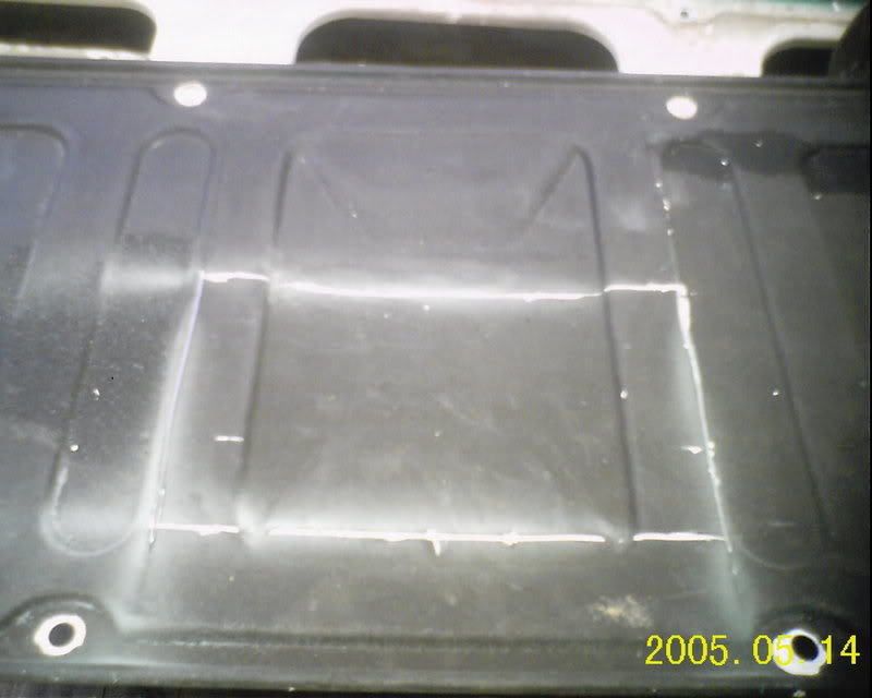

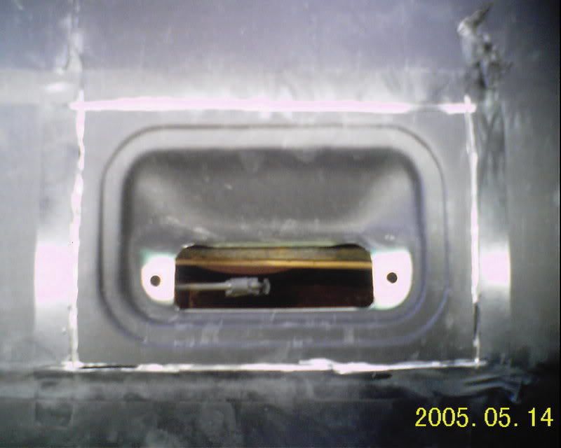

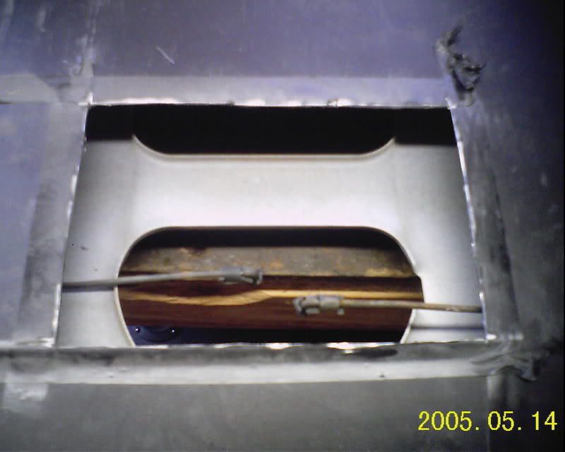

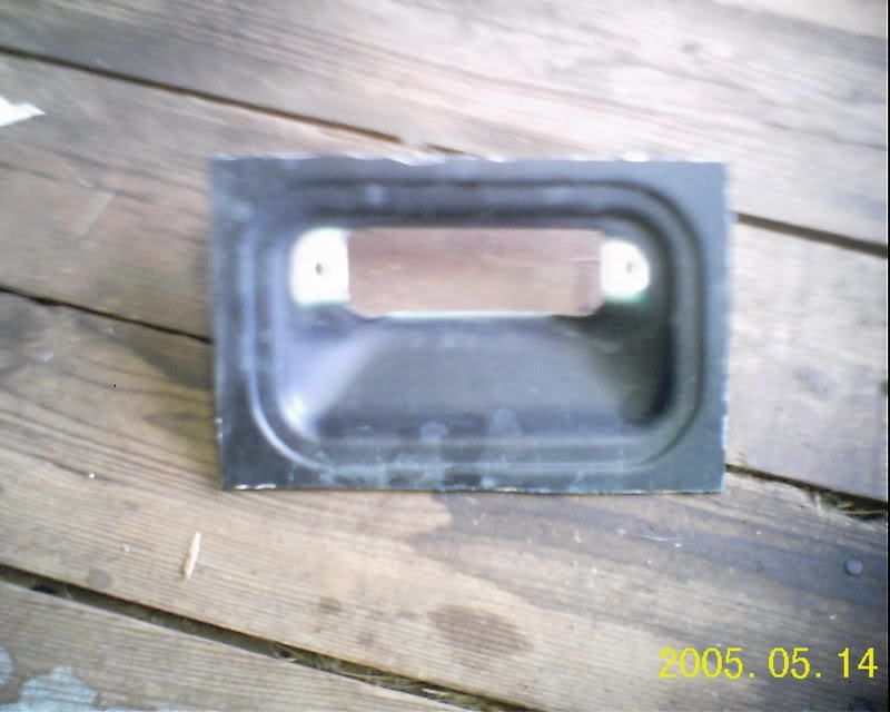

well here is a few pics of what i started and i welded it up today but didnt get the chance to take pics of it.
finished pics to come when i actually finish it.
