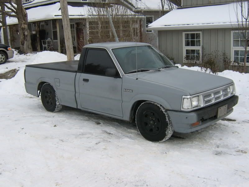

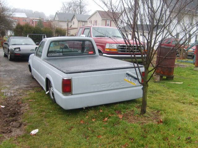

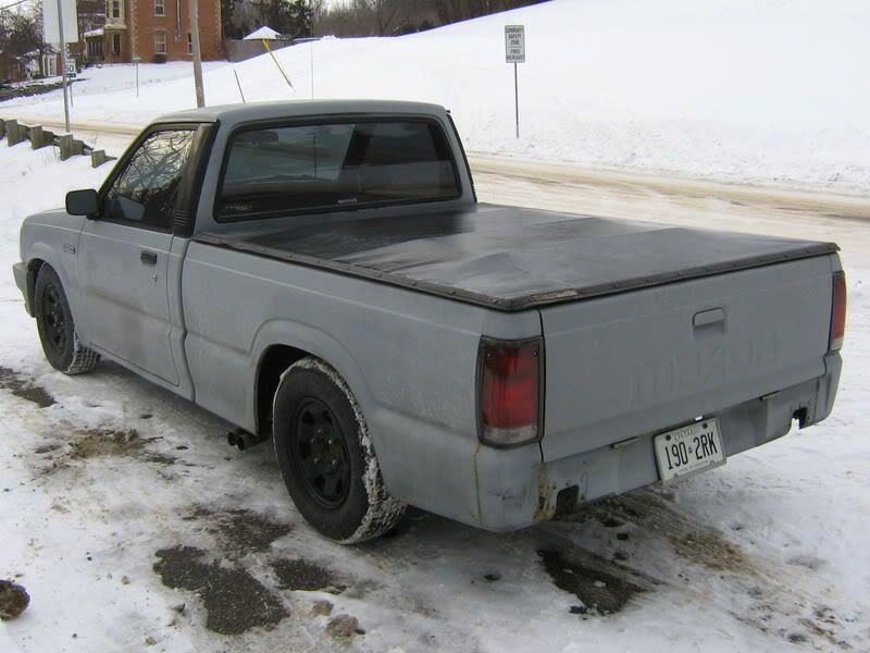

go to walmart and go to the model car section there they have little cans of model car paint grab a can of the transtar candy apple red transparent, stuff up the tailights alittle bit and spray real light coats the model paint likes to run put as many coats on as u would like, them let it set for awhile, after its dry begin spraying clear over them red i have done it on my mazda and my 240sx heres some pics the 240 i painted the center black.
