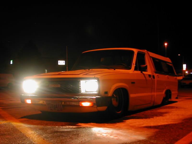

Valiant - have had a walkthru for probably 10 years now. Changed the interior a few times but basic construction is probably similar to what you were wanting.
immortal1 (linn)'s avatar
immortal1 (linn)
ps - link has more pics of the same
