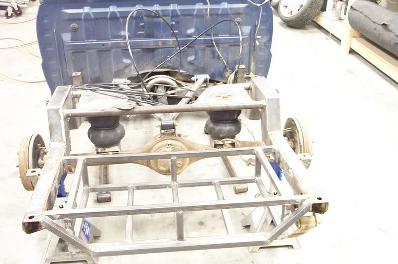

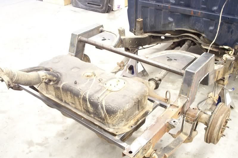

has anyone moved the stock gas tank to the bed. if so does the factory gas gage still work. i am building a bed cover so i am not worried about what it looks like.

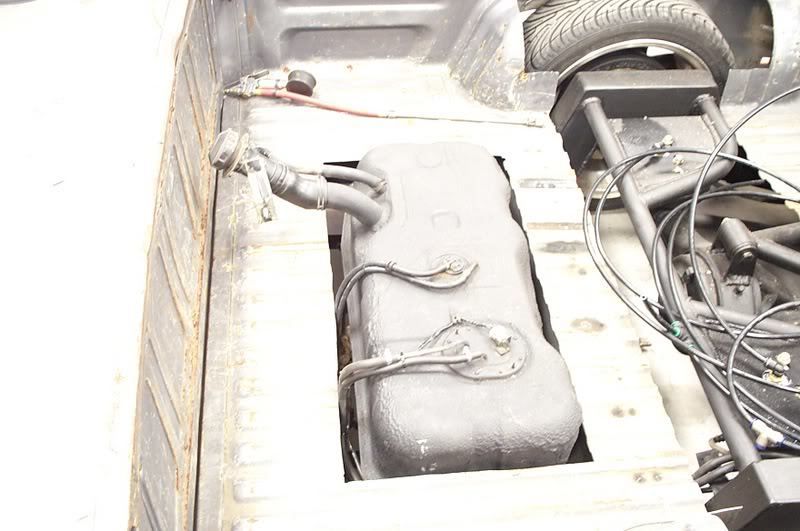

I moved mine to the bed and its stock, and I have no problems Just had to extend 2 wires and 3 lines and no problems.
gravity5's avatar
gravity5
yeah, it will work fine...the gauge is just an electronic sending unit, and it will work regardless of where it's mounted...as long as the tank is mounted with the top up....But I wouldn't put it under a non veneted ebdcover though....

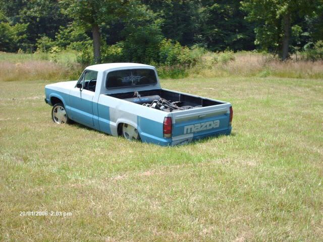

draggin84
my bed will be cut out for the notches, I was thinking of putting it by the tailgate and putting my air tank in the front behind the cab, I am building a custom bedcover and i didn't even consider any way of venting the tank, but that is something to think about
slammed83mazda's avatar
slammed83mazda
Thats my exact setup
oldskewlkool
yep cut and splice the wires without mixin em up, does fine, you have a little more gas than you think when it says your empty though
