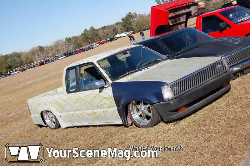

bagman
do what i did...instead of laying down some solid graphix that will cause problems when u go to sand it down to paint(tape lines r hard to sand out)tape u off some grafix the normal way,then instead of piling on some color,just mist on a "guide cote"...no tape lines to sand out in the future

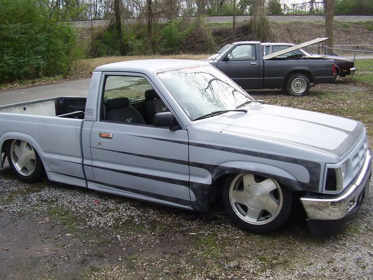

that looks cool for being only primer and flat black,
down2earthdawg's avatar
down2earthdawg
guide coats are fun
gray with green guide coat and stock painted fenders
