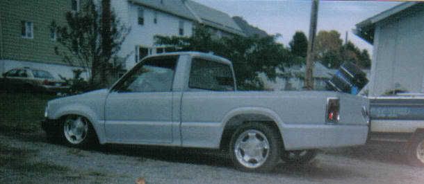

hillshovercraft
i have a shaved tailgate and caddy tails on my 88 check it out at

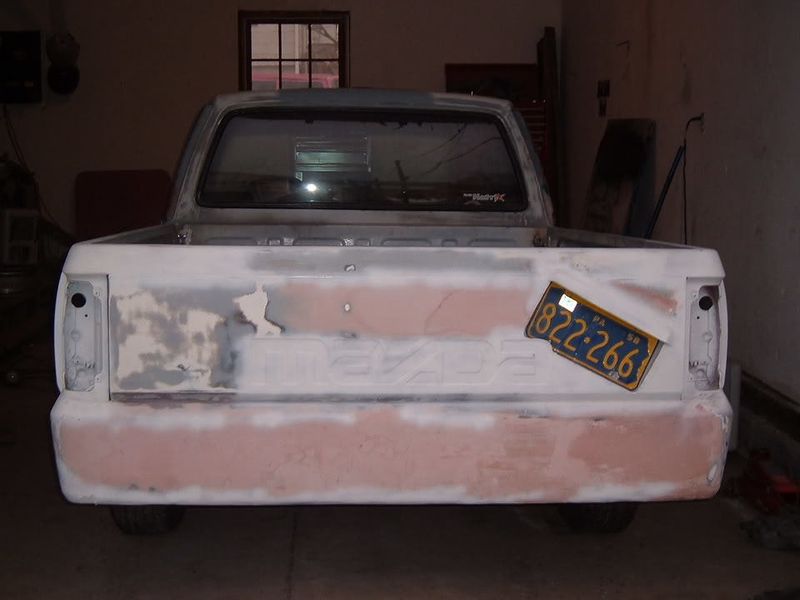

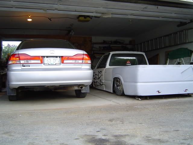

baggedb22
MazdawgyDawg i only have pics from like a year ago but here's what it looked like the week after i started on it.
heres it in november but u can barley see it there the only pics i got right now.
baggedb22
Remember everything was hand fabbed from the license plate box to the rollpan.
