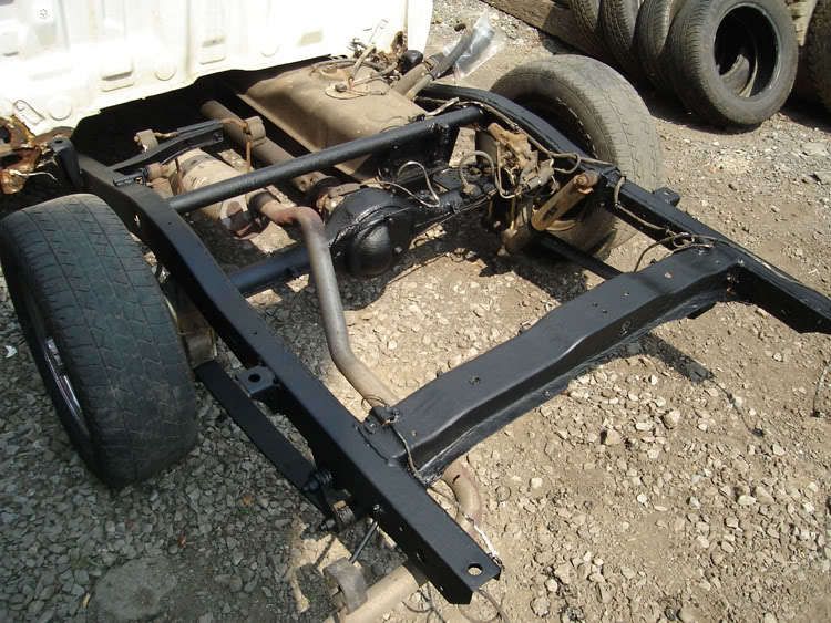

So my buddy told me about this new stuff called Chasis Saver?
Supposodely you can paint it right onto rust and it will neutralize it and last too! Kinda skeptical, and its runs like $25 for a quart, which is supposed to be enough for a whole frame.
I was thinking about using that and then putting a good thick coat of rust oleum over it.
Any suggestions and what you guys have done?

I ended up cleaning it with a wire wheel, then put two coats of flat black rust oleum on it. Looks pretty good.
