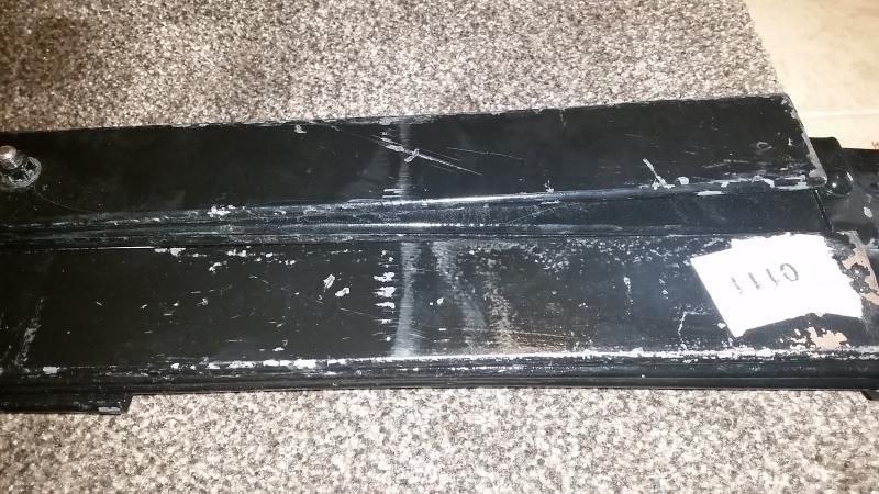

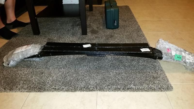

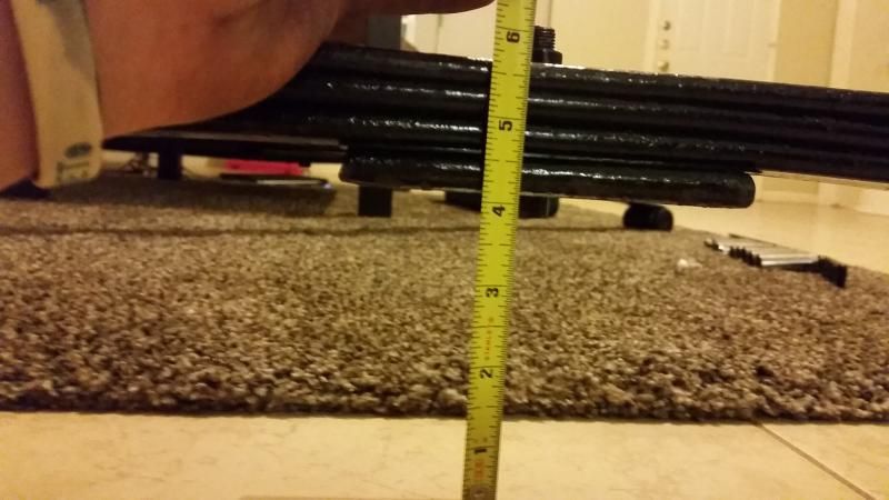

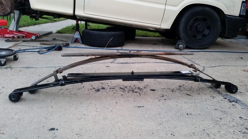

Y'all may have seen these on eBay, they are the Street Edge 3" lowering leafs for the 87?-93 B-series trucks.
They were $209 shipped, from California. Got here (Houston) in 4 business days. The packaging was awkward and they look like they've been through hell. Not to mention the paint looks like it was done by a toddler. Again, I'll compare them to the 'factory' leaf springs tomorrow when I install them. I say 'factory because the previous owner seems to have removed a leaf or two.

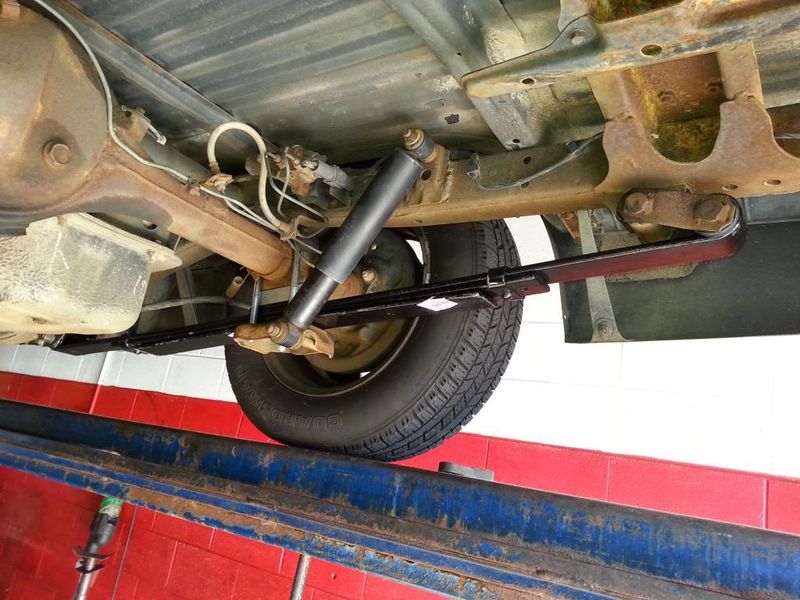

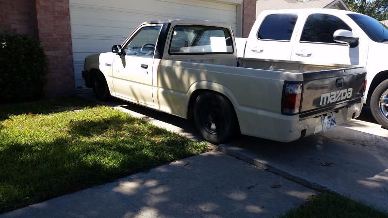

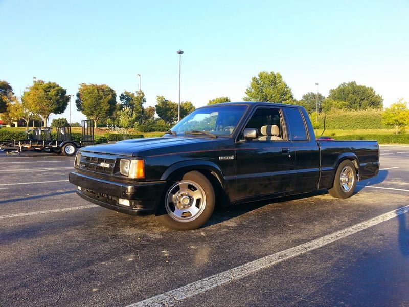

Just finished. At the bar "celebrating".
It lowered the truck 3.5" measuring from the bed wheel well to the ground. 27.5" "stock" to 24". BTW, it'll probably go lower, but the axle is literally against the frame, prohibiting more drop, for now.

Nice! Looks like they brought the rear end down to a good height!

A few notes I made on my install:
-i had to loosen the drive shaft joint to move the rear diff far enough back to reach the leafs on both sides
-my rear shackles are pretty much hitting the frame from the additional length
-i had to change my stock length shocks out for 94 Nissan quest minivan rear shocks (1.75" shorter) to improve ride quality, stock shocks were pretty well bottomed out
reallyslowrio

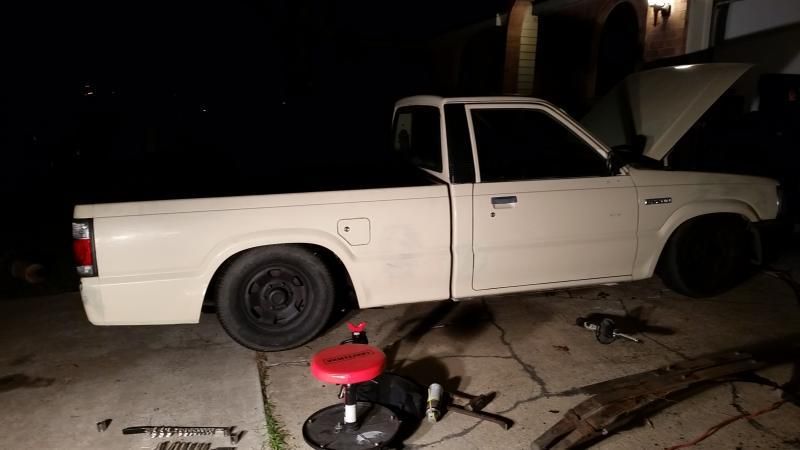

I didn't have to loosen the driveshaft, but the axle definitely had to come back at least 1.5" to set the alignment pins.
Shackles on mine are the same.
I'm running the Nissan shocks as well. Definetly a good upgrade.

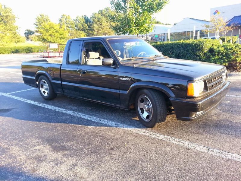

Here's another picture from earlier today. I'll get more after the notch.
